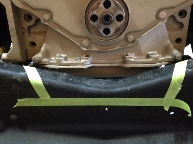

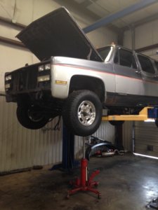

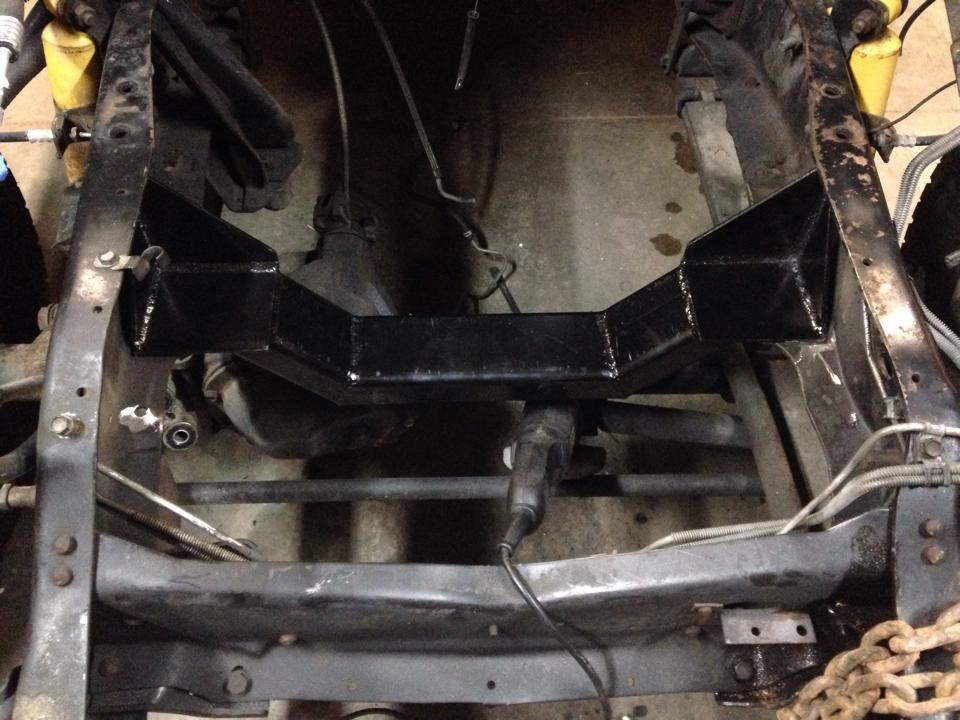

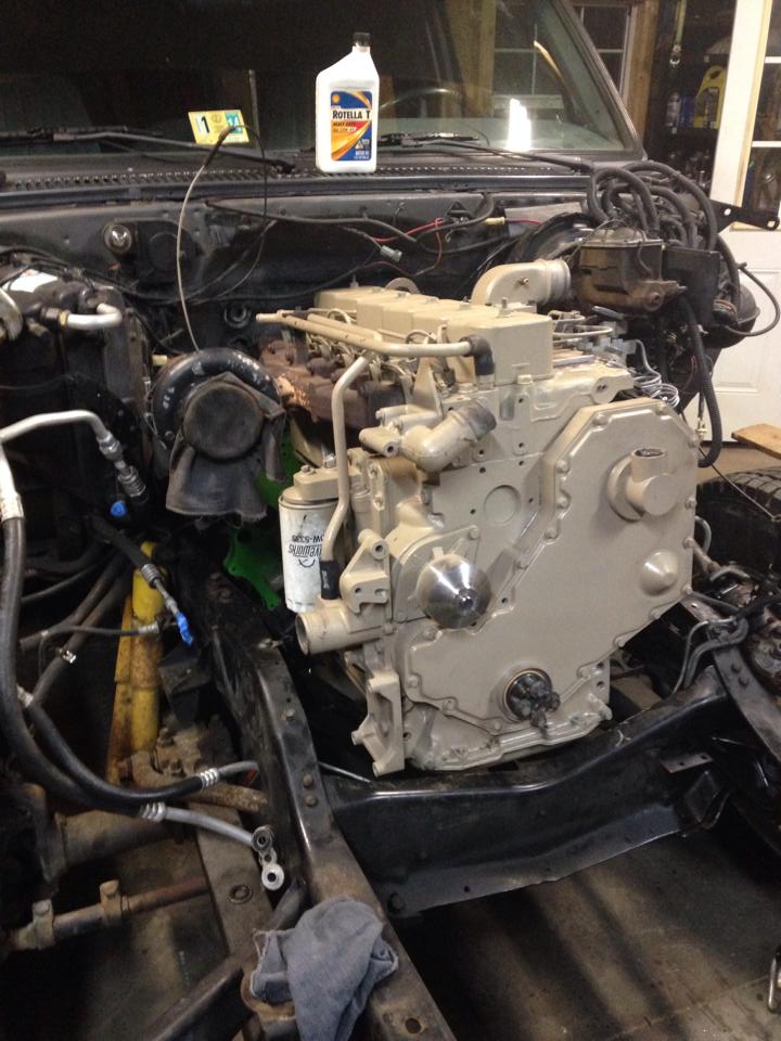

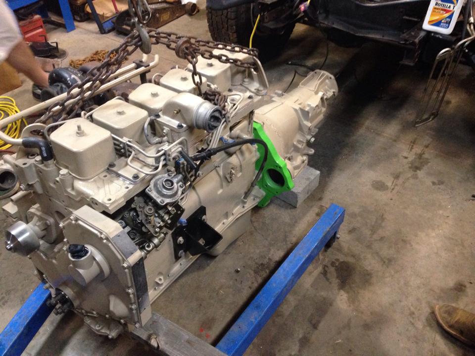

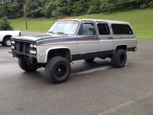

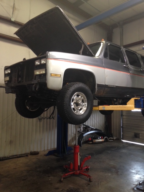

lift.jpg Cummins12V.jpg DieselBURB.jpg Installed.jpg clearance.jpg This project has been in the works for a while now, hopefully its worth sharing! I picked up the 90 Suburban 3/4 off craigslist for a deal with "engine issues" for a deal. Got the 350 up and going and knocked around in it for a while until I found a Dodge donor truck. Pulled the Cummins & freshened it up a little. Normal fuel modifications, all new gaskets etc. For a trans I went with a 1st gen A518/618 OD, billet internals, low stall converter, and a NP241 case. As of now I'm waiting on the driveshafts to be modified and a few other goodies to come in.
It is an OD trans, Its basically a non-lock up version of the 47rh in the 94-96 CTD Rams. I'm going to run them for a while. I've had my eye out for a FF14B and a d60 for the front. They are a decent chunk of change. I hope to get it up and going before winter and see how it holds up!
