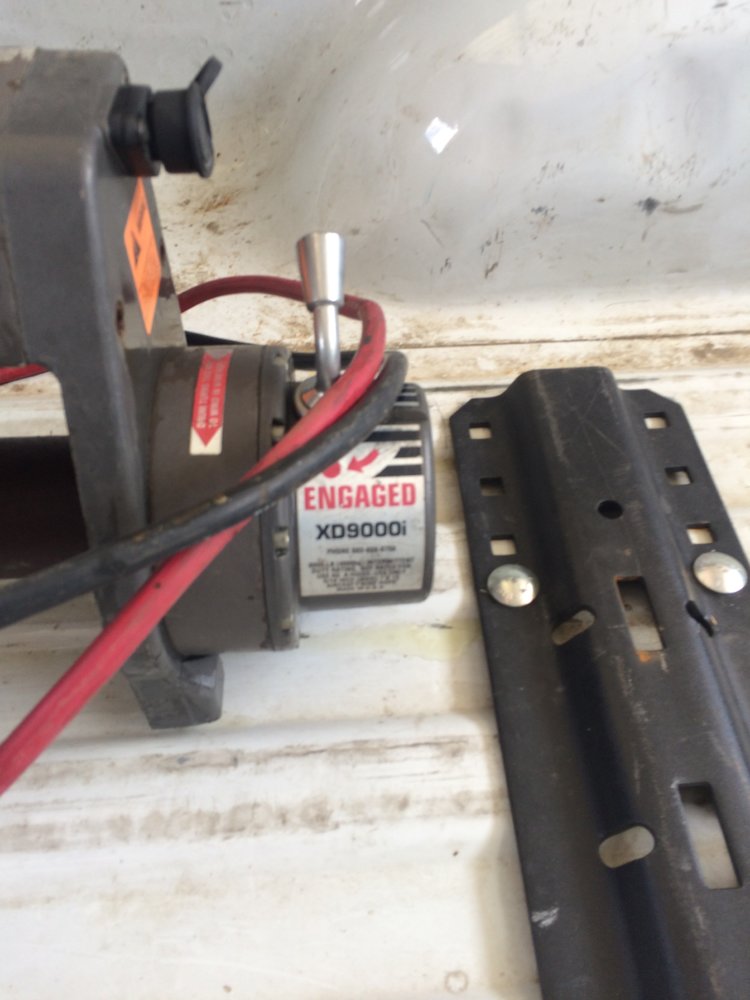

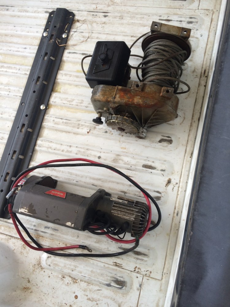

I was just reading through this thread out of general curiosity and then today I stopped by a garage sale and found these two winches and gave $100 for both. Looks like I am in the same boat of rebuilding a 8274. Both of them go in and out but the 8274 is in rough shape.

It was more of an estate sale I think. I guess the old man had passed and the wife and the kids were cleaning out all his "stuff". I have a Warn already so had the remote to test them. They were covered in barn dirt but I sprayed them quick at the car wash. I don't intend to keep them so what am I realistically looking at for a resale value. I understand the 8274 needs a going over and the cable is shot. The XD9000i has no cable or fairlead. Is it worth it to put a new remote and rope on both and do a rebuild/ lube on the 8274 and expect to get any sort of return? What's the fair market in y'alls opinion.
