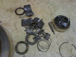

Last trip of last years season, first attempt to lower kodak rock. Got to the top and got excited then left front tire dropped in a hole------- snap.
i ate through so many hubs in the black cherokee...proablly 6-7..Sticky compound tire + D44 hub + wheel spin = POP every time.. 50.00-60.00 bucks everytime you lite the tires sucked balls.
i've heard that mile marker's premium hub are a good deal....money wise. lifetime warranty? correct me if i am wrong
Well the warn hubs are lifetime so thats good. Its just the time to take them both off(because you change them in sets) and take a ride to 4 wheel parts. I am going to invest in another pair so I can at least ride out the weekend when I break one.
thats why i have 4 sets of warn hubs i take with to ure when i make trip up there i wont to wheel bc it takes me 2.5 hours ot git there it only take 30-45mins to fix but if u dont have any it a bad ride home

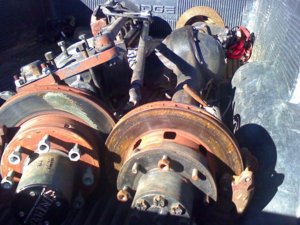

That's why you throw the warn hubs in the trash and put the old far far stronger spicers back in. Why spend the time replacing them on the trail? Also, what rear axle is that in pic 9? Some sort of eaton?
