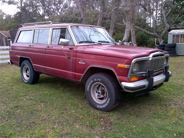

Well, I pick this gem up the other day, and now waiting on a free tow to my house. I could probably be driven but I don't want to risk it before I dig into it. I'm new to FSJ's and not that knowledgeable about the years and makes. There is some cosmedic rust but I wasn't able to see any major locations. The price of the truck was too low to get too picky. Ran 6 months ago when parked.

It has 3" lift springs already on it.
(later learned its stock springs with only cut wells)
This will be a slow moving project.
Got it running this past weekend, needed a fuel pump. This weekend is the carb rebuild.
