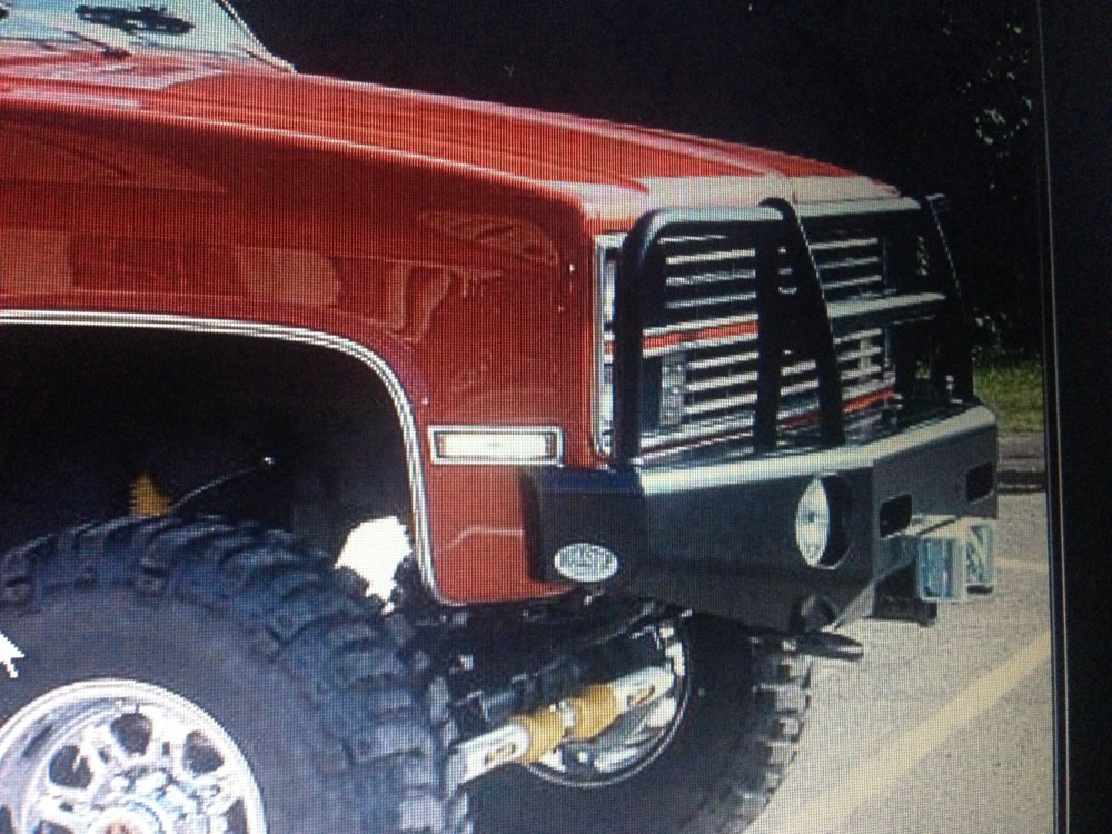

I have an 1986 Chevy that I'm looking to have a bumper built for, what would if cost to have something like this built?

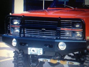

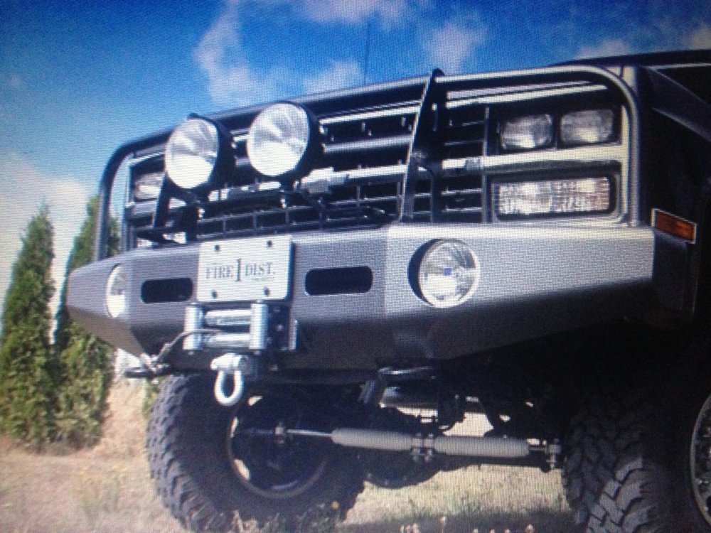

This is somewhat like the one you posted, we don't production run these but I can speak with my partner if your interested in us building you something. He built this for his son.
I'm pretty disappointed with the lack of decent looking and affordable bumpers for 73-87 Chevy trucks. That one is sweet, I'd just do something different with the grille guard to suit my preferences. Wouldn't mind knowing a price on one of those though!
I have an 1986 Chevy that I'm looking to have a bumper built for, what would if cost to have something like this built?View attachment 64433 View attachment 64434
However much it cost to buy it from them plus about 15 hours labor is usually how I price bumpers like that. The company that sells that bumper has someone who laser cuts the thing out then breaks all the seams till they touch then weld it up and its ready for powder coat. When I build one like that I have to cut each individual panel and fit it all together, then weld every single seam unside and out, then I spend 2 days with a flap wheel making those seams look like the smooth edges on the "store" bought bumper. It literally takes 2-3 days for me to build one like that.
