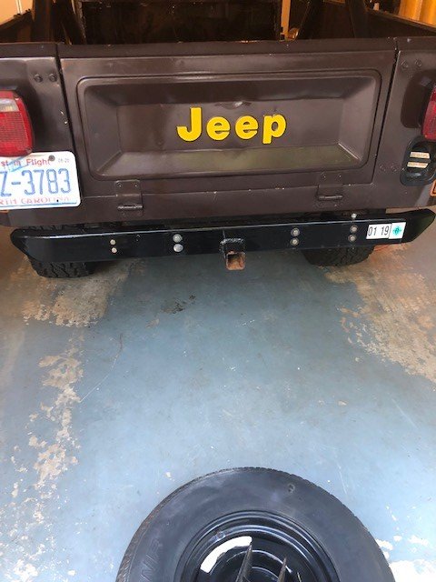

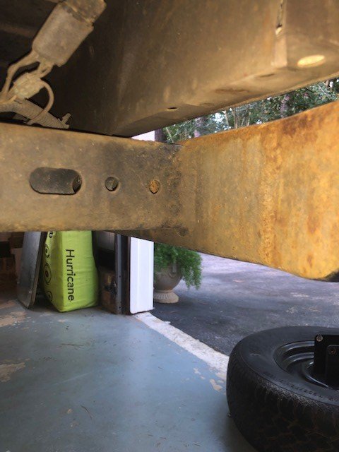

So, i'm in the process of upgrading a few things on my Scrambler and came across my rear bumper. Mind you I've only had this jeep 1 month, and i'm discovering new things every day. I want to put on the LOD Expedition Rear Bumper and Tire Carrier(https://lodoffroad.com/products/jee...xpedition-series-bumper-tire-carrier-519.html ) and I noticed my existing bumper is welded to the frame...... :-/ There are no bolts to remove it and the bolts in the picture are for YJ bumperets that were installed by the previous owner to pass inspection in Hawaii. What are my options here? Thanks for the help.

PO cut off original rear crossmember (probably due to damage trying to pull something) and replaced with the bumper.
I can’t tell from the pic but unless some fab work was done you’ve lost the rear body mounts since they are in the rear crossmember.
If you cut that bumper off you will need to replace rear crossmember so the LoD has something to bolt to unless you want to go the welded route again.
