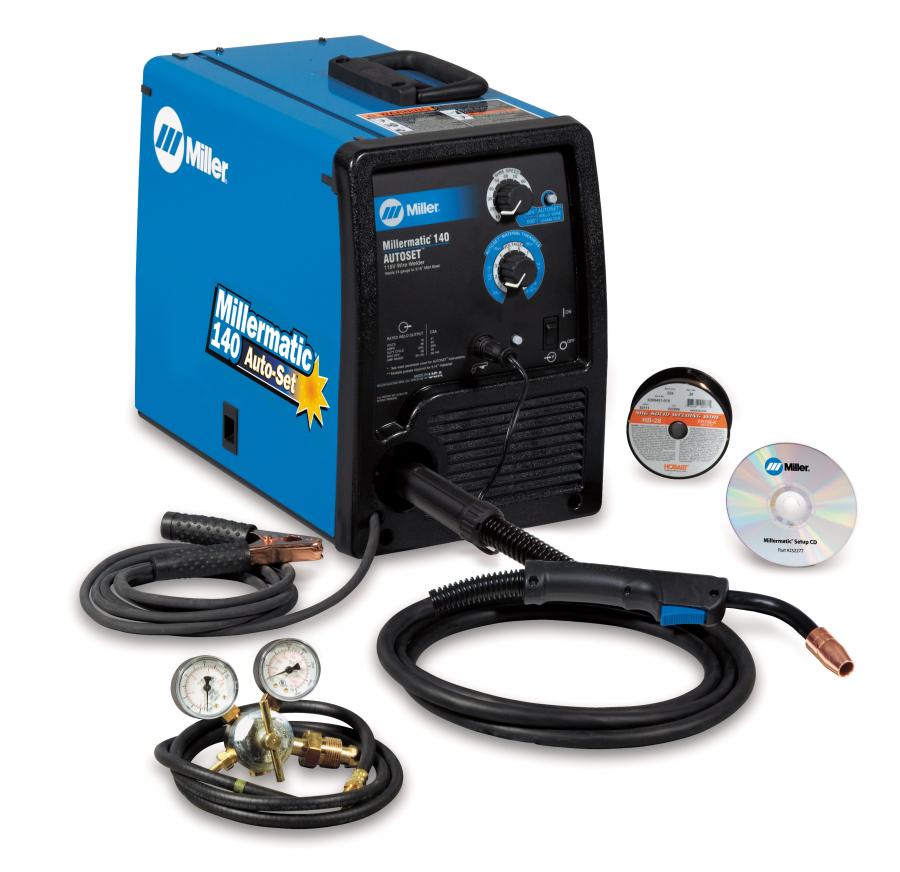

Hobart Miller Millermatic 140 All-In-One Wire MIG Welder w/ Auto-Set, 115 V (~$700)
LINCOLN ELECTRIC EASY-MIG 140 WIRE FEED WELDER
(~$730)
in my VERY VERY limited experience, the millers are better machine's...but the lincoln's have much better guns..........so either way you'll have a quality piece.

Right. My bad. It is still a nice welder, though. I've played with a 140 and a 180, and the auto-set feature is a great feature. Necessary? No. Easy? Yes. And it does get the parameters right for a nice bead in the flat position. I don't understand why the 211 is the dual-voltage model in that line, that's a big welder to run on a 110 circuit!
