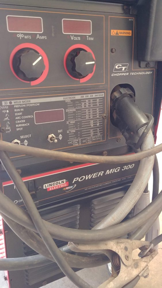

For the professional welders out there
What’s your thoughts on a Lincoln power mig 300, supposedly mig, tig and stick all in one
Supposed to a great mig, looking more at the tig functions for aluminum work?
Pros cons let’s here it, I am a self taught welder that can glue somethings together, never done any tig welding but I am interested in learning it

I didn’t know the power mig line had ac capability. I thought it was dc only tig.
I thought to weld aluminum, you need a spool gun to mig aluminum, not tig aluminum.
Yeah I am not sure, that’s why I was asking

I used a 255 like that where I used to work. Never really blew my skirt up. It could lay down some metal, and it had pulse capabilities, but it was overly complicated IMO, and kinda temperamental. If you get it, get the manual and learn it. There's a steep learning curve attached to all those features.
Mac is spot on.....they do pulse Mig and pulse spray transfer with trim settings. Pulse spray on 16gauge to what ever. Enough umph to run flux cores and dual shield like a boss in .045 wire.
DC tig is nice but not supper supple like an older tranformer. 99 percent certain it's also lift arc or scratch start only. Not deal breaker just a little different finness.
Biggest perk is they run in all the voltage ranges. A lot of machine this size are really happy turned up but struggle on the low end.
If I wasn't clear....the pulse Mig is Tits.
Not a bad stick welder either. Not excellent for 6010 roots but it'll run them fine too.
Smokes 7018 just fine.
Used many of these units one after another....not a single internal failure in 2 plus years.
No a.c. tig.
Oh, also has synergnic setting where the machine matches volts to wfs. A neat feature but we also turned it off to teach welder operator set up....sometime the machine can get "unbalanced" in this mode.
Multiple power inputs also allowed.
