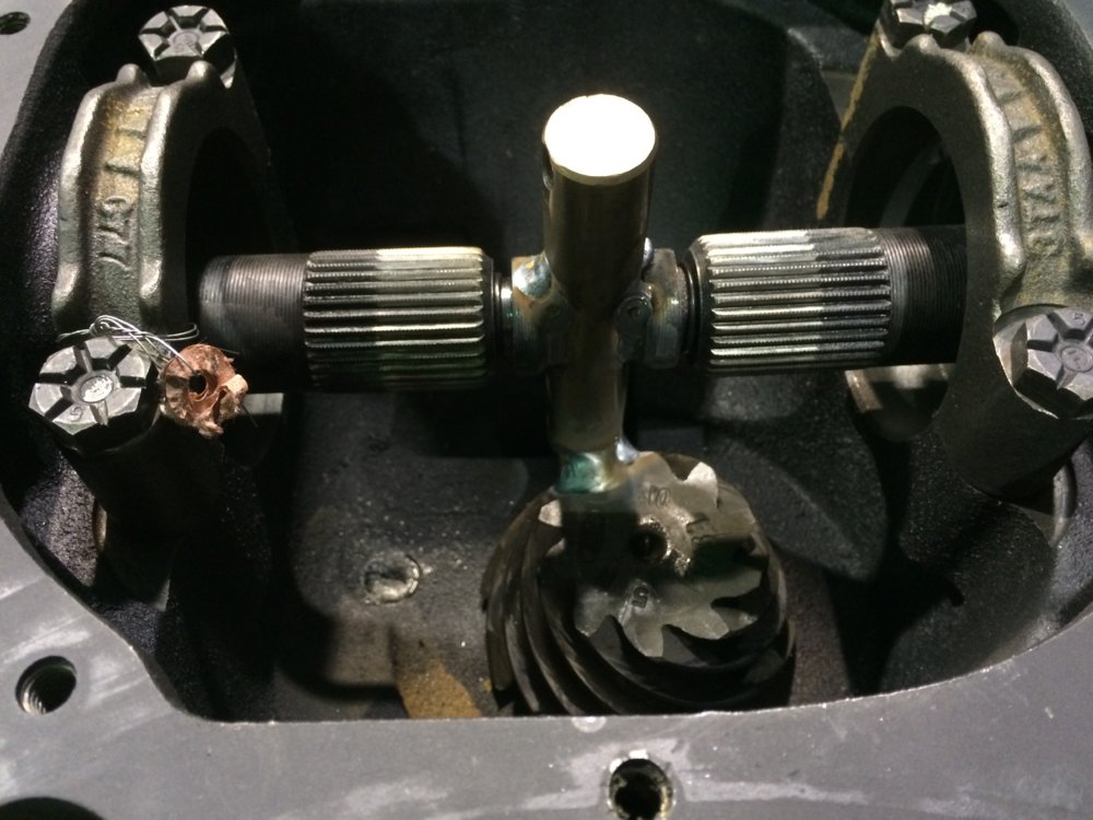

If I Lincoln lock, I weld the whole thing solid. I did the fozzy thing once and the spiders tried to climb out of the carrier and trashed it.
I'll give my opinion: you eliminate all weak links spiders, center pin breaking, lockers have springs/clutches which are still moving breakable parts, and as others stated you can still remove it if done right but while welded solid, you have less parts to strain and break and all stress goes to axles which can take more abuse than those other moving parts. and it's free.
Example: many D35 rears welded solid will outlast a open or locked D35 almost every time...I would know. good luck
