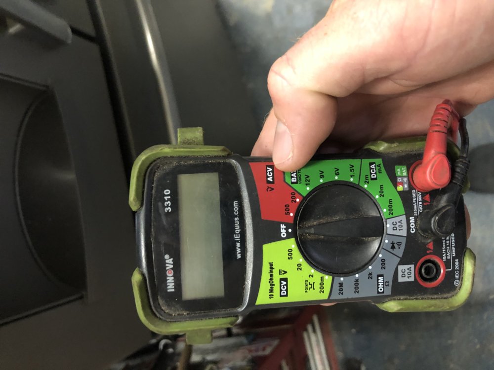

-I have a meter but it’s a cheap-o-Reilly unit. Not sure it does the job or I’d know how to make it work. (I’m not a good electrician by any means!)

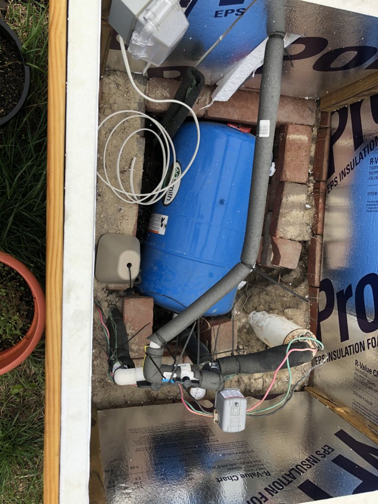

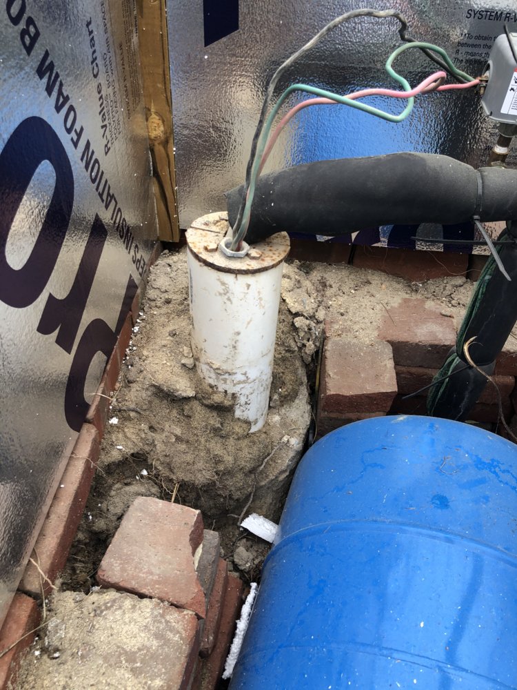

Pics of the well (pump house)
Definitely a drilled well. Meter doesn't have a "amps" function. Most used to be a sepearate clamp on devise, the good ones. Some are fork type. You'd also be trying to catch a moment in time when trips.

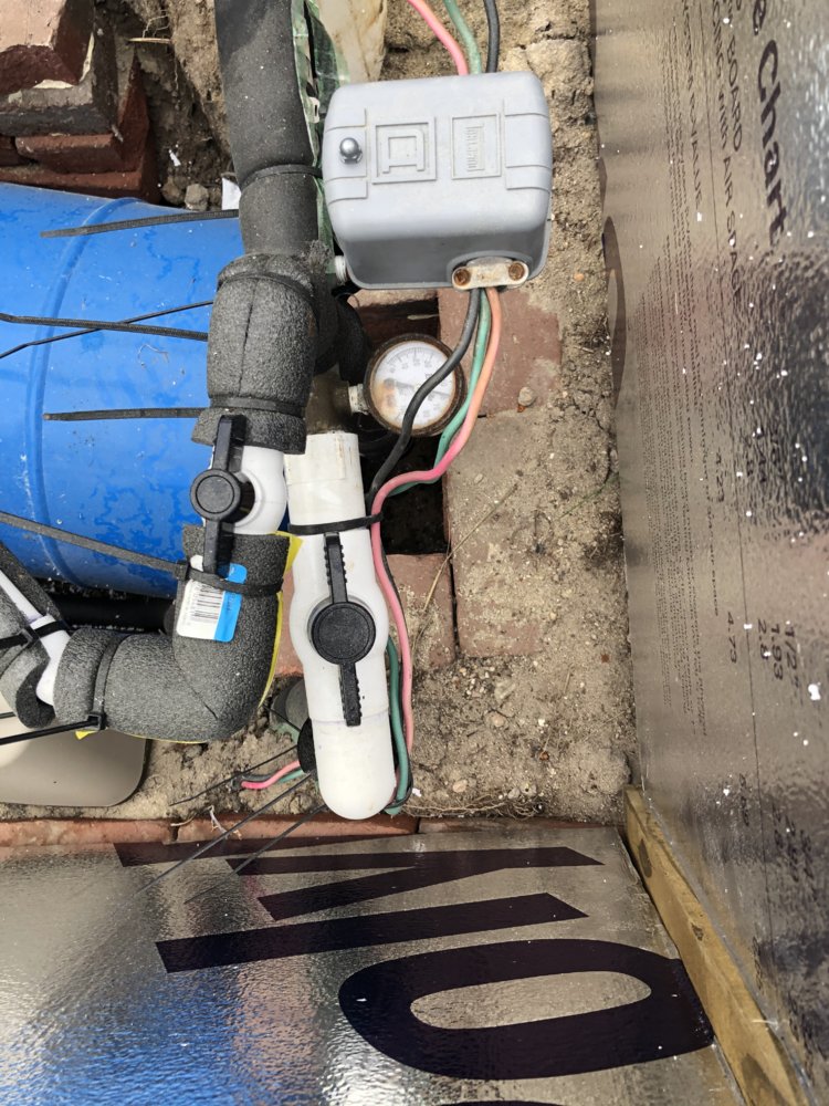

If you start fixing stuff that's the wrong connector wire combo at the pressure switch and will cause problems eventually.
It could have just been fatigue yesterday causing the nuisance trip. If so the breaker needs to be replaced or it will continue. Once the thermal trips enough the metal loses its "spring "
do you mean wire type? or the strain relief on the wire? I wanna learn too.
I can't comment one way or the other definitively on wire type from the photo given.
But the connector on the PS is for a jacketed/sheathed cable. As those cables flex over gime with starts the connector will cut into the insulation and cause an arc/short. May take weeks may take decades but it'll happen eventually. It will also allow moisture into the PS and cause it to fail prematurely. To run those wires into it as is, a grommetted connector would be better. Something with a strain relief and a neoprene seal that tightens under compression.
like what @Ron said. What connector wire is wrong? Learning too.
Edit: apparently you were responding as I was. I get what you’re talking about now. I can remedy that too easy.
