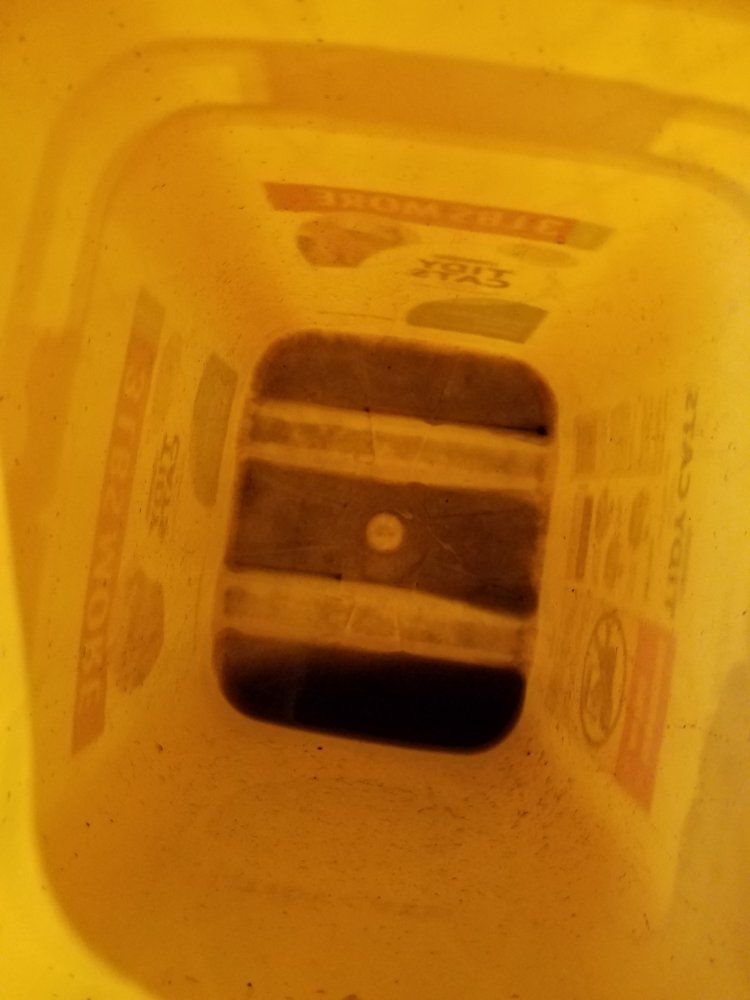

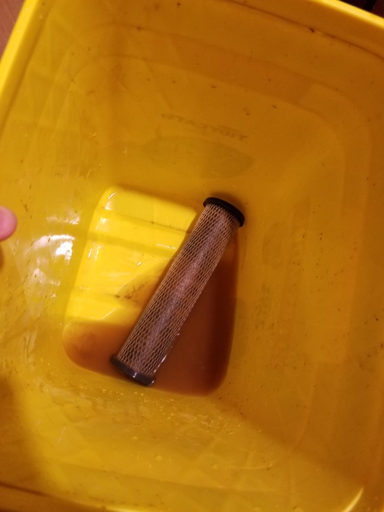

That's when I noticed the filter housing was murky. emptied it again - full of reddish silt. Filter has a nice dark red tint to it now. See pic.
Note, I replaced the filter last weekend when this first cropped up.
It's cooling off now, I'll let it pressurize once w/o the filter and see if it can make it.

yep, w/o the filter in place, it pressurized OK. I cleaned out the filter and put it back in. Repressurized ok. re-started the laundry so it could empty and go back up.... Have a couple of gauges on it post-filter, which what I normally read by... added one to the tank drain before the filter for comparison, while it's building up, there's a good 8 psi difference, but once it kicked off at high pressure that dropped to ~3-4 psi difference.
I really wish I'd had that other lower guage on it earlier when it wouldn't keep up b/c I now highly suspect that the crap in the filter housing was preventing the flow.

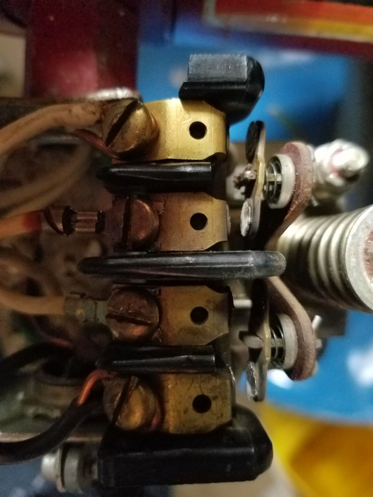

I got to looking at it closely and noticed the contacts were almost totally gone, worn out - see first pic. Also the jacket on one of the motor leads is a little dark like it got hot. No idea how old this switch is so I de3cided to just replace it.
Put on a new 30/50 switch.

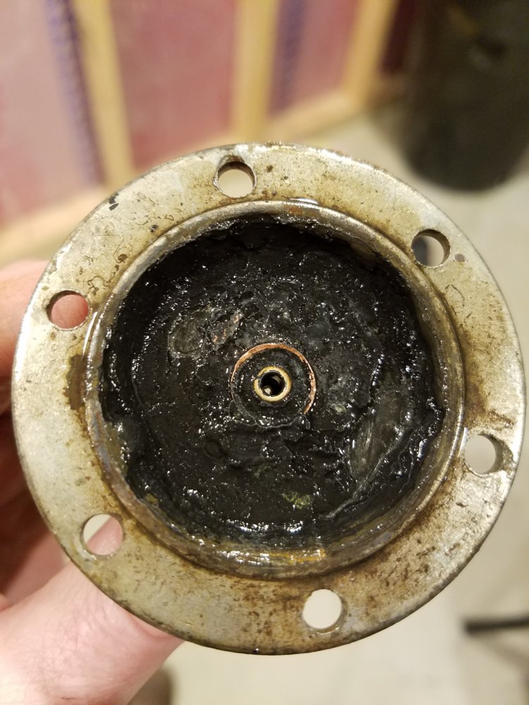

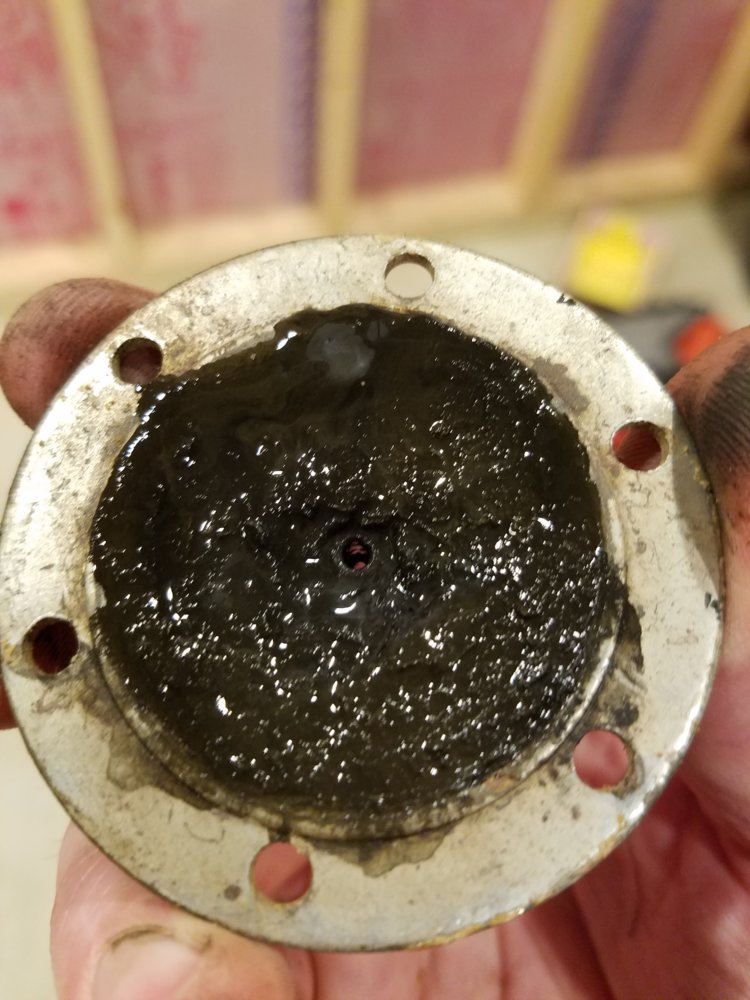

In the process I learned the water up under it at the inlet was nasty - dark black and a little sticky. After swapping it out I took the baffle off of the old one - see the 2nd pic. Caked up w/ tons of black stuff. I guess it's just murk that's been building up? Even after cleaning it out as good as I could, it was very much pitted and permanently colored like it's been there awhile. I'm sure this is what was causing the switch to fail.
This makes me wonder though what kind of crap may be built up in the pump? Maybe that's why it's starting to show signs of struggling?
While the water was off I went ahead and pulled the bad gauge off of the port on the pump... the inside of the hole was also full of black gunk. I scooped as much out w/ a wire as I could. Figured that was why the gauge didn't work, unfortunately it still doesn't, but maybe it now has crap in the gauge itself.

I have a friend that has had issues with this lately as well. Pressure switch diaphragm gets plugged with crap after only a year or two even though their water is generally clear. Causes the pump to have issues running.
