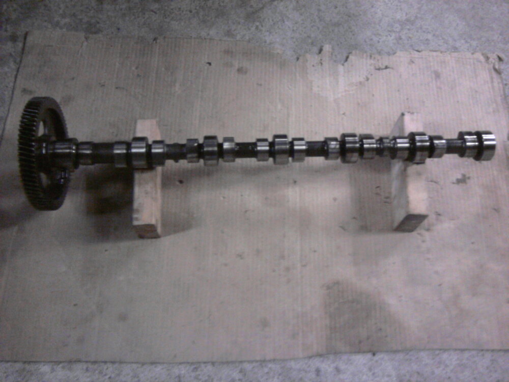

S480, for sure. Even better with a forged compressor wheel. The flow is much better vs an S475. Since you're doing studs/springs/pushrods, I will always suggest a cam while you're at it. With a compound setup, you can actually drop boost (resistance) and gain power from the extra air flow and efficiency.

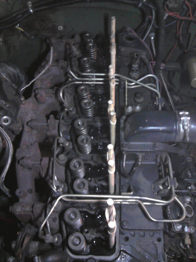

Wasn't planning on pulling the head for this phase. Isnt that required for the cam swap? As usuall I'm on a budget too ya know...
Nope! Just have to hold the lifters/tappets up. On the newer trucks, I see most folks use magnets. Older ones like mine, a 1/2" wooden dowel with a bevel and a slot works perfect. I still have that fancy lifter tray tool too. I did a Hamilton 181/210. They're not terribly expensive. Even a small one is a lotttt better than stock!
