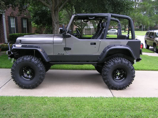

jody dropped a color idea which got the wheels turning. right now the prevailing idea is aircraft grey with warthog nose art (used to work on them in USAF)
Really open to any neat ideas really. My outlook has quite flipflopped after this weekend lmao. So the goal is to find a rattle can color that has a gallon sized option. This way i can use my equipment to spray and keep a rattle can around for future touch ups.

^ This lot of the plain grey looks terrible when sprayed, is definitely try to find a grey with some silver in it
That's a good point. Any recommendations on a silver grey or metallic gray? Would gun metal grey be too far off the grey path
If you're trying to stay with cheaper paint and not try to spend house of colors money on paint, duplicolor makes a brilliant silver metallic that can be had about anywhere.
Either metal flake or gun metal.
I'm a big fan of the RustOleum Hammered paints. Can get it in a rattle can or big can for a sprayer or even brush or roller on.
The great things about it is that it has just enough visual texture that it hides imperfections super well, and can easily be sprayed over to touch up.
I once painted a 4Runner fiberglass top w/ it using a roller and it worked out really well, just takes some practice learned how thick to do it and how it works when you re-pass over it.
It's most common in a black but they have a grey very similar to the first post, and a lighter greyish silver.
Get tungsten metallic base clear and go from there. It's an awesome color used on dodge and ford. Just dust the base, lay incremental clear to build it up and a wet final coat. Then do your graphics or details on top of that.
