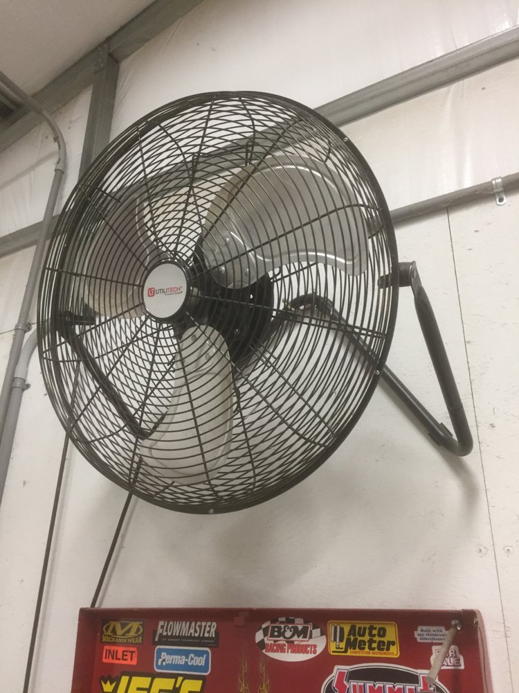

Mine is movable. And I don’t have a hole in the wall.
