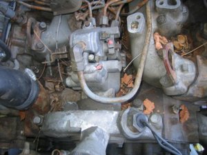

Picked this up with some other stuff the other day...what enigne is it?
Crank is broken...that sounds fun...

Yep, looks alot like the 6.9 IDI sitting in my dad's dumptruck.
IIRC same block.
Only stroke is different.

Same block... different cylinder BOREs! Definitely either the 6.9 or 7.3 NA... being an '87 (if original to the truck), my guess would lean towards 6.9.
Check drivers side valve cover for decal. If missing, your only recourse is to pull a head to check the bore diameter...

So...I'm looking around on the intraweb here...seems that the injection pumps are the same on the 6.9/7.3 NA's? Is this true? The injection pump...and maybe the heads...would be the only reusable part on this motor as the bottom end was ruined by the crank breaking...says a diesel mechanic who inspected it when pulled.
if it came out of an 87 F-250, then don't worry about the smell, because it is a 6.9
Yep. Our 86 F350 has a 6.9IDI.
IIRC, its as follows:
6.9 IDI 83-87
7.3 IDI 88-94
7.3 IDI Turbo 92-94
7.3 DI Turbo 94-03
