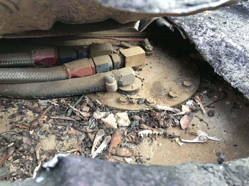

its a long shot but anyone know what type fuel pump this is or I need?

Here's a picture that may could help?

If it were me, I'd remove that pump assembly and then match up the actual pump itself. It'll be much cheaper than buying what you currently have.
Most all pumps have generic part numbers stamped or engraved onto them.
This is a last minute situation, trying to get it running for the big lick truck pull and mud race. I was able to get the fuel pump out today and it was the same one I guessed at and ordered. Hopefully I will get it running tomorrow and not find anymore problems!
