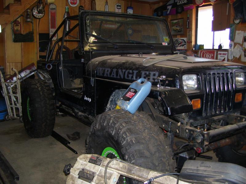

do my own alignment with a tobacco stick and a degree finder.lol
