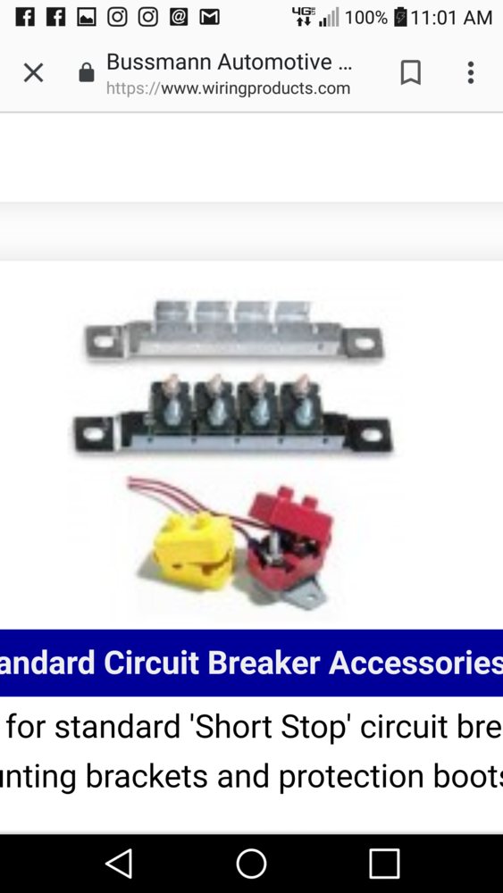

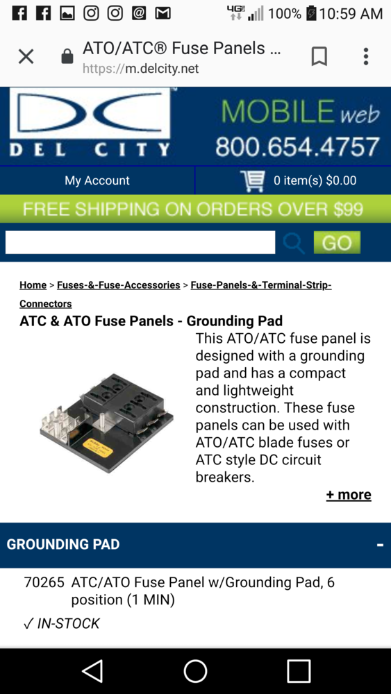

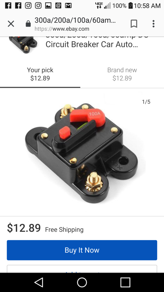

Supplying......
Which feeds...
Or....
Everything but the winch......over fancy maybe. Protected. Definately. I dislike burnt stuff from wiring.
