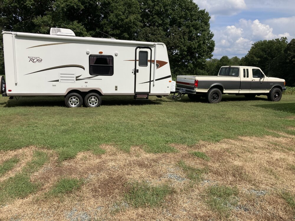

Well we made it back but that was not fun! I was worried about braking, but That was not the problem at all. The truck really struggled pulling up any sort of grade. When I was almost home, and stopped at an offramp, I looked down and my oil pressure went to zero. A little blip of the throttle and it would come back up and stay and then it would drop again. I did not see this until I was just a few miles from home so I went on home and pressure stayed OK most of the time. After I got everything unhooked for the truck back up and drove around for a while and it seemed perfectly normal again. Don’t know what the heck that was but not good….🙄 i’ve had this truck several years and the oil pressure was always rocksolid right square in the middle of the gauge.

It probably got the oil hot and thinned out. An oil cooler would help, but there ain’t but so much you can do about the power. Were you letting it gear down and rev high? Some people think they’re hurting an engine by revving it hard and they want to lug it but a gas engine isn’t going to make power down low. With my GM 6.0 and current 8.1 truck it’s very normal for me to pull a grade at 4,000+ RPM.

I’m sure you guys are right, I’ve just never seen oil get hot enough to do that I guess and it kinda scared me that something worse had happened.
And yes to the above, I had down shifted it into second, and even first a time or two it was creeping along At close to 4000 RPMs. I think I’ll be looking for a suburban in my near future. If you guys know of anything available, please let me know.

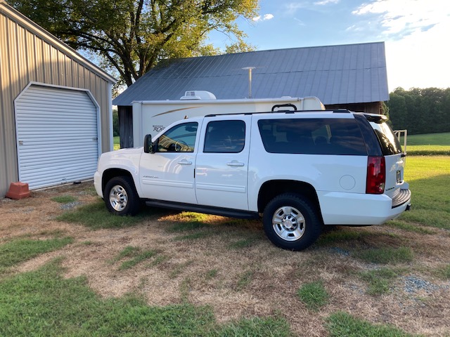

Well yesterday was the big car shuffle at our house. Traded my wife's 2012 Highlander for the 2013 2500 Yukon XL tow rig/hauler. She will now drive my 2015 Lexus. Also kind of fell into an opportunity to buy my 92 yo Aunt/Uncle's low miles 2007 Buick for my new DD. They are both 92 and married 71 years as of yesterday; amazing! Anyway, they just decided to quit driving and offered it for sale to family. Prob paid a little too much but it's nice and wanted them to get a good deal too! Thanks for all the input and advice.
Good looking Burb! Can’t wait to hear your thoughts when you pull the camper with it, keep us posted.

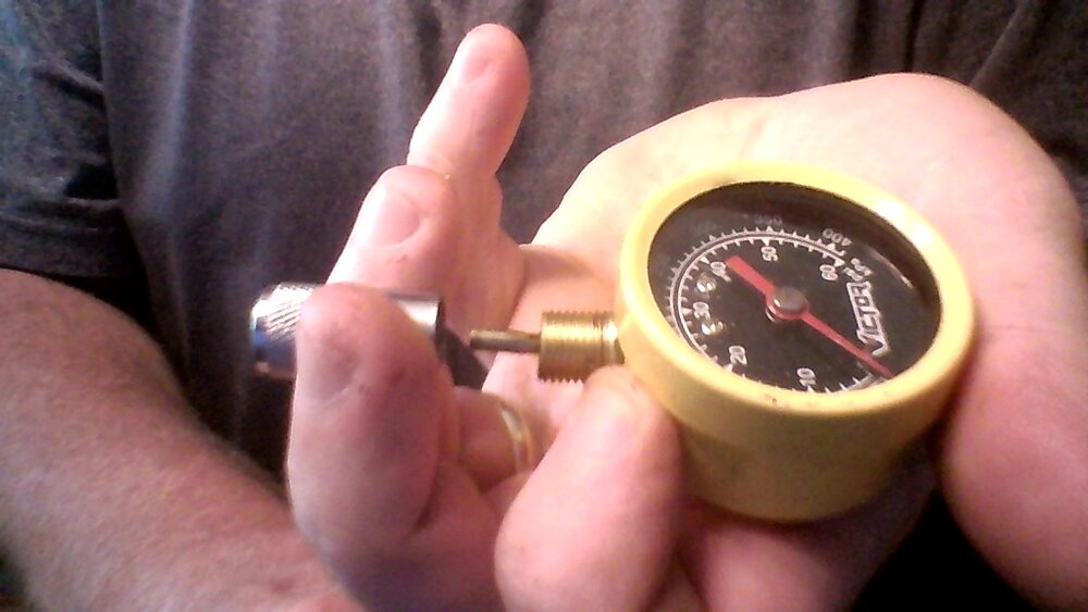

Trick for checking the oil pressure... Get one of the cheaper tire gauges from the auto parts store (picture) and remote the stem. There's a 1/8" npt input! Put on a little plumber's tape. Find the sending unit ("sensor") on the motor. Take it out and put the tire gauge in. Voila, active/real pressure oil gauge to check the real pressure at the motor. (i.e. checks back to see if your sending unit is working)
