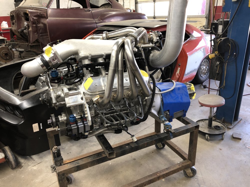

Hope you are getting a custom converter built just for this?
If not call PTC, give them all your details including gearing, tire size, cam specs, weight etc. they will build a converter for your application. Install and be happy.
Best thing we have done behind the 502.... it’s light years better than off the shelf rated “stall” converters.
