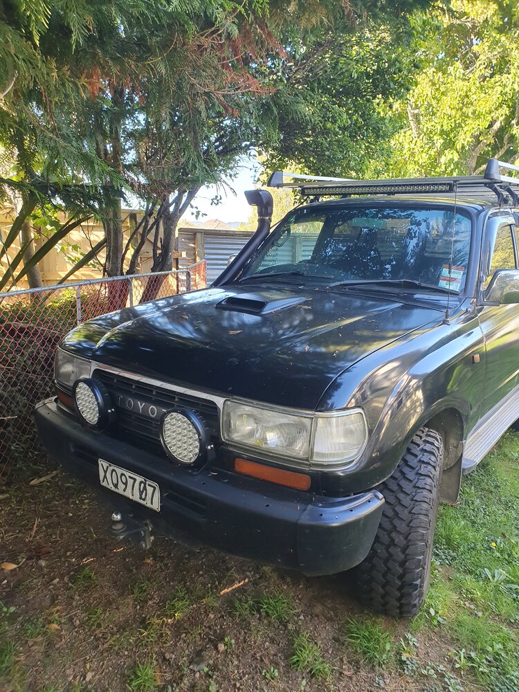

Hi Franklin, I'm wanting to put a ford 302 into my Toyota 1994 4x4 Landcruiser, any ideas on what 5 speed manual gearbox I could use with out to much hassle. Regards
That sounds like a terrible idea.
I have experience with HDJ80s and 302 fords and unless you have a very well built engine and low range requirements, you're gonna hate it.
That said, the easiest would be to adapt your Yota bellhousing pattern to the ford one and run the Yota trans.
