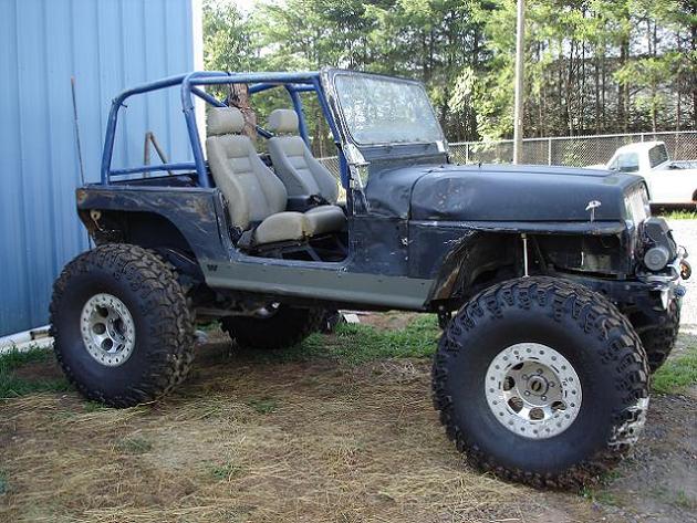

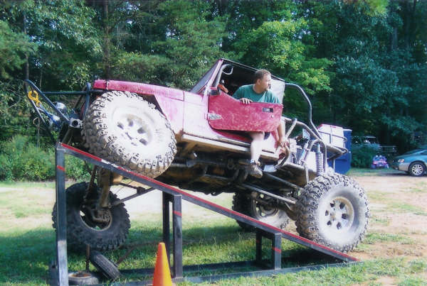

The sigs only tell part of the tail. So, I am starting a thread on trail rigs. What mods and so on. Tell all you want about your trail rig.
Mine started life as a 85 CJ-7. Not much left of the original Jeep. The only thing original to the one I bought as a stocker is the hood, Frame, and Tranny. Everything else has been replaced or changed.
118" wheel base, stretched all in the rear.
Dana 60 front, Corp 14 bolt rear. Both with Detroit lockers. 4:56 gears
Rear has disk brakes also.
Front has hydraulic assist, KC4X4 high steer arms, with tie rod behind the diff.
Tractor supply tubed PTO shaft hybrid front drive shaft, Chevy Blazer lengthened rear drive shaft. CV's on both ends.
Home made tie rod and drag link, with 3/4 heims
39.5 Super Swamper Boggers.
Weld on Bead locks
3 1/2 inch BDS Wrangler lift springs,
Spring over axle
Rancho 9000's all four corners
Front half of cage is from a 95 wrangler, back half home built
Mile Marker 12,000 lb winch with in cab controller
Seats are Junk Yard re covered with marine vinyl
Brand new maverick harnesses
Booty fab console made from amo box
AMC 360, running on propane
4 core radiator
power steering cooler
York OBA, with two air tanks to run all air tools
T-176 tranny and Dana 300 t-case running 4 to 1 Terra low gears
To be installed this week, Pertonix igniter to take the place of my points dizzy
My Pane tanks sit on a rack which is hinged and can lift via a pneumatic cylinder to access a hidden tool box made possible from the frame stretch
60" Hy lift
Big parts and spares box, tool box, recovery box, Cooler, Vice
Ready welder on board
Soon to have a new strapless Bikini top
Windjammer
Tub is cut behind the seat and enclosed
Cobra 25 CB
Velcro grab handles
3 Optima red red tops
Rock lights underneath for front and sides
added single rear reverse light
Hella Drive lights
Probably more just can't think of it right now

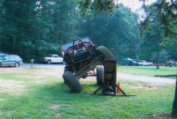

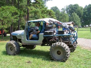

:confused: Mine started life as a poor old 90 YJ with a 258 carbed. Now it gets its motivation from a:
Stroked SBC fuel injected L98
NV4500, centerforce clutch
Atlas II 4.3
Front axle: Dynatrac Pro-Rock 60
Rear axle: Dynatrac 60
Billet high steer arms
AGR ram assist
ARB in both, 5.13 gears, 35 spl. nodular covers, disk brakes on all 4
High Angle drivelines F+R shafts thick wall tube 1350 & 1410, F+R same and 2 spares too
King Coilovers 14" F+R
Front three link with panhard bar
Rear DBL. triangulated four link
Back half tubed and body sectioned and welded back together
Custom soft top
42" Iroks on 17x9 wheels with Staun internal beadlocks
15lb. Co2 Powertank
Ready Welder
full air tools and many spare parts on board.
Rock lights
Front winch: Warn HS9500I with synthetic rope
Rear winch: Warn Xd8000I with cable
Both winches controlled inside cab
2 Optimas with painless Dual Bat. Isolater
Msd offroad ignition
HEATED Bestop Seats
Be cool Aluminum radiator
Mark VIII Fan
Front spotlights
Rear reverse spot
Grab Handles
Wally Crawler
cooler and chairs
And last but not least, a loose nut behind the wheel.
I am sure there is more but.............:confused:

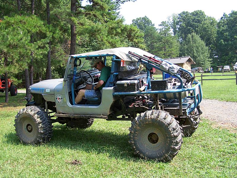

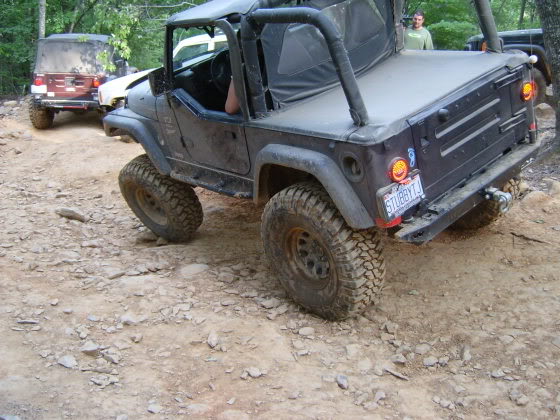

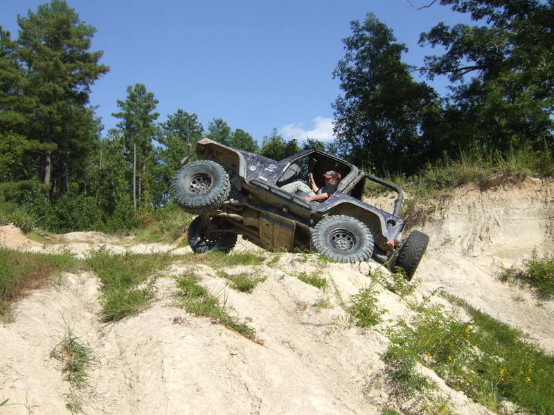

I have been building mine so that it can be run reliably on the road while still allowing me to have some fun offroad.
2000 TJ Sport
RE 4.5" springs
Currie adjustable J arm LCAs
RE adjustable UCAs
Bilstein 5100 shocks
JKS ACOS
MORE 1" BL kit
MORE 1" Bombproof Torsion rubber MML
35x12.5 Interco TrXuS MTs
15x8 black Rockcrawlers with CRS rock rings welded on
Staun internal double beadlocks
Aussie lockers front and rear
Warn X8000i winch w/ synthetic rope and aluminum fairlead
CRS adjustable front trackbar
V8 ZJ tie rod
2002 4.0 (2000 4.0 got a hole in it around 106k)
LUK Pro Gold clutch
3 row all metal radiator
JB Conversions Super Shorty SYE and custom rear driveshaft
Dakota Digitial signal converter
Stock NP231 TC and NV3550 transmission
Ford 8.8 w/ MORE bracket kit and Warn diff guard
Rocker guards
Offroad Tech rear bumper w/ home made tire carrier
48" Hi Lift
OBA
Home made in-cab winch controller
Windshield lights
Cobra cb
Wilson Silvertip antenna
Bike rack
Fire extenguisher
Mastercraft handles
2 piece soft doors
Home made discos
WebWheeling.com stickers
Custom pinstriping
Waiting to be put on:
Steering box skid
Rockcrusher front and rear diff covers
'68 Jeepster Commando
4.3 TBI Chevy V6
SM420
D20 w/ twin sticks
Currie 9" rear and 44front w/ Detroits, 4:88's disks
Rancho 9000's
AGR pump and box with ram-assist steering
6" Alcan springs
36" IROKs
Electric York OBA
Custom cage, bumpers, tire carrier, skids, etc (not much aftermarket for Jeepsters)
Warn 8000
"Tuned up" Uniden CB

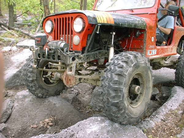

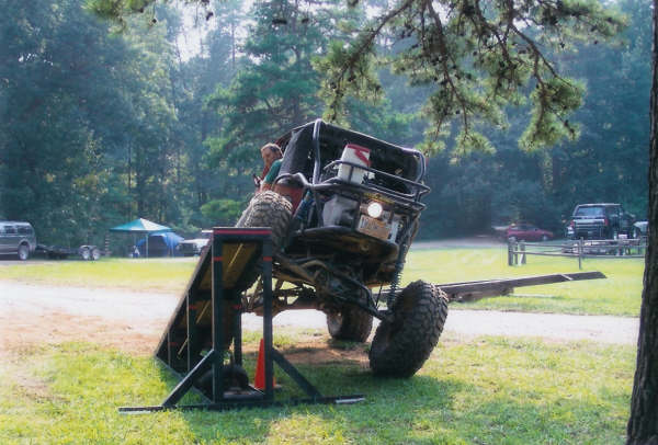

I have a sami tubed out with 5.14 transfercase gears, 4.10 axle gears, buggy leafs with yj's in the rear, RUF with missing links up front, locked front and back, streched 8 inches, webber carb and soon to be waggy axles and a 4.3 this winter.
Jeff
Frame:
yj frame, narrowed about 9" in the rear. its overall length shortened by 13". (YJ = Square headlights)
Wheelbase is 103", frame height is 19" at the belly, overall height just under 70".
all arms are DOM, cage is a mix of dom, and hrew. DOM IN MAIN STRUCTURE
Weight:
3160 lbs
Motor:
1999 jeep 4.0(bored 50 over with high comp head. 50k or so about 230 horse) (probably TJ because of EFI)
tranny:
TorqueFlite 999 auto from 99 tj (2.74, 1.55, 1.00, 2.20 reverse)
Case:
dana 300 transfer case 4:1 ratio (30k or so) (tera low kit)
hd rear output
front:
79 waggy 44. warn shafts; yukon super joints 4;56, lockright.
rear:
85 yota w/ stock shafts. v-6 third. 4;56, spool
37" BFG krawlers on 17x8 soft 8's
brakes:
rotor; 89 chevy 1500 front
caliper.82 chevy monte carlo. yeah, I know!
rear radiator: 95 jeep XJ
f driveshaft: stock XJ, lengthened to 38" (for memory)
r driveshaft: XJ rear, shortened
control arms:
triangulated 4 link front , currie johnny joint/re bushing , 2" x .250" lowers and 1.5" x .250" uppers. 6" XJ coils in custom buckets moved high up on the frame.
Rear is a wishbone 3 link with the same tube specs. Stock TJ rear coils out back. Rear, RE joint/re bushing (rubicon express) all lowers are 2" 250 wall DOM Uppers are all RE bushing 3/4 heims
Hydro stuff:
Danfoss orbital, Cheif ram.
All hoses are off the shelf parts from Tractor Supply 24"/36"
wow, in all honesty, I can't remember half of what I have on here, so I will try and go in order to what I did
1 inch body lift
warn front bumper(wait stretch that, its gone)
warn rear bumper, tire carrier
bank header
those little handles that help the short people get in
jks rockers, I LOVE THOSE!!!
custom front bumper, made like Moore high clearance, but 1/4 steel (now I might when a battle with a telephone poll!!!)
That little shackle thingy in the back that I use so much
8.8 rear, locked (but I can not remember the name of the locker, limited slip)
I can't remember, 4.56 gears or 4.11 or something like that
4.5 Rubicon express super flex
35 inch MTRs
those black soft 8 wheels
blue torch gas tank skid
teraflex belly up skid
super sized cup holder
3 toggle switch's that do nothing but look cool (add 10 horse power to each switch!!)
some radio, mp3 and xm, remote never works
That little thing that tells you what degree you are sitting, but I never use it
oro rear lights, and reflective tape
custom made nc4x4 sticker (10 more HP)
soon to be mall-rated badge, and a huge windshield banner sticker (more HP!)
fire extinguisher sitting next to the high lift
a trail cover
front tow hooks
rancho steering stablizer
a bent front tierod
I figured with all the random stuff and things I forgot, it at least looks like I have something if you just glance at this post, but if you read it.. :banghead:
minus the custom sticker
minus the tera flex belly up skid, and my passenger who decided not to join me (WHY I wonder?)

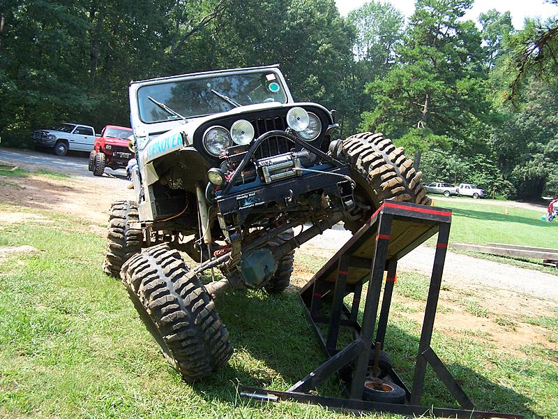

My junk
-92 YJ frame and tub
-78 CJ Front clip
-started life as a 4 cyl 5 speed- now it has a 4.0/aw4/231
-5 leaf waggys in front with 2 extra leafs added
-xj rears with an extra main leaf
-C&C 14 bolt rear, disc Brakes, 5.13 presicion gears, Welded
-waggy 44 front with chevy 8 lug outers, yukon 4340 shafts and joints, warn premium hubs, 5.13 precision gears, detroit locker
-38 SX's on 15x10 Chrome Mods with Rock City Fab Beadlocks
-Rock City Fab Cage
-102" Wheelbase (soon to be 106")
-1 ton GM TRE's
-JB Conversion SYE
-8000 lb winch
-Custom Winch mount and front bumber
-Custom anti-wrap setup
-Very trick flowmaster Exhaust setup
-K&N intake
-Fuel Cell in tub
-comp Cut rear (soon to be dovetailed)
I am sure there is other stuff also that i am forgetting
Its still got a long way to go, with lots of mods to come, but works very well

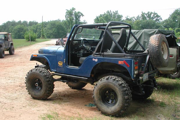

'72 Jeep/Scout/Bronco
AMC 304 w/ MC2100 & TFI ignition
TH400 & D20 w/ homemade twinsticks (& leaking adapter seals)
Front D30 converted to disc brakes w/ Detroit EZ & Toadworks U-joints (297x joint w/ bushed 260x caps)
Rear D44 w/ everything TIG'd
Both running 3.73s w/ 33" Swampers on rusty chrome bullet holes
SOA on de-arched OEM rear leafs & 3" Downey (rear mini-truck) leafs up front
Homemade rails, bumpers, & winch mount w/ bastard NH/REP800
Full cage tied to the frame
Stereo, amp, & WallyWorld speaker box
POS Cobra CB (stays wet more than dry) & KI40 antenna
Multi-colored (lovingly applied) paint
Only driven to the store for Tickled Pink and to church on leap years...

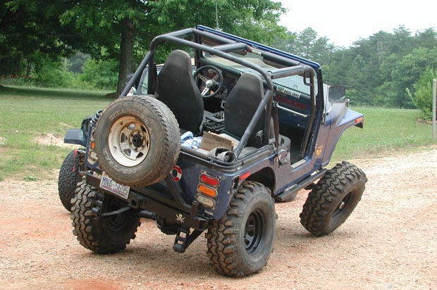

TFI/HEI Hybrid Ignition
SOA on XJ Reaf Leafs all the way around.
Shackle revesal

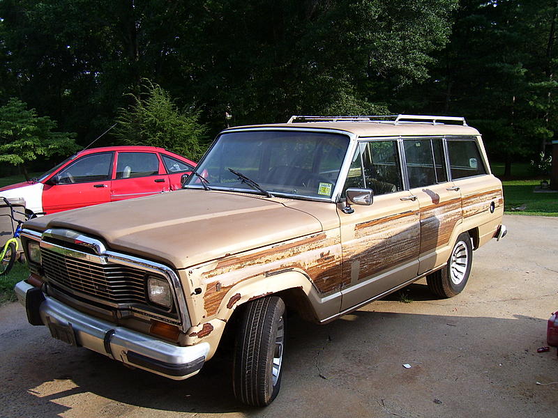

Some sort of homemade beefy Tierod and Drag link. Came with axle from Ebay.
Waggy Power Steering outfit that needs a new pump and a Hydro assist ram.
Ford E350 Master Cylinder
home made rear bumper and tire carrier
NAPA tree color tail lights. I hate red blinkers
Need to install Traction bar that's laying in the basement.
and I'm sure some other stuff I'm forgetting.

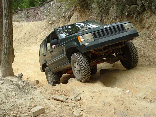

Also a '93 ZJ 4.0 with 230K miles on it. Daily Driver
RE 3" lift and 31" BFG MTs
CRS bumpers front and rear

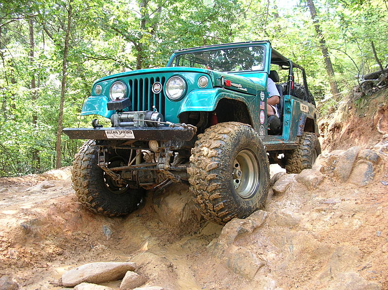

4.3 TBI Chevy V6
SM420
D20 w/ twin sticks
Rancho 9000's
6" Alcan springs
36" IROKs
Electric York OBA
Warn 8000
Nice...really nice

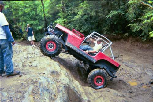

we'll see what I can remember...
2001 TJ
4.0L, NV3550, Atlas 4.3
HP30 w/ ARB, Alloy USA Chromos, Dana 4.56's
D44 w/ ARB, Alloy USA Chromos and Teraflex disc conversion, Dana 4.56's
12" Swayaway 2.0 coilovers all around
36x13.50 Irok Radials on 15x8 Rock Crawler Soft 8's w/ CRS rock rings and Stauns
frame chopped in front of the rear axle, tubed out underneath the rest of the way, to ~101" wheelbase
19-gallon RCI fuel cell
Currie HD steering system
full cage
MileMarker 12000 winch w/ Amsteel rope and RockStomper aluminum hawse fairlead
15# CO2 tank
dual fire extinguishers
diamond-plate half-doors by SSWaters
Skid Row engine skid, steering skid, radiator skid
T&J front diff cover, Teraflex rear diff cover
RE belly-up skid and long arms w/ RE tri-link setup (rears all stretched)
Blue Torch rear comp corners
CRS rock sliders
BudBuilt winch plate
stinger, radiator guard, and some kinda "rub rail" I dreamed up from stinger to rear bumper
CRS rear tire carrier
3" lap belts
CB/XM
front and rear Rock Equipment swaybars
CJ turn signals
flush mount brake lights and backup lights
all fab work (other than the half-doors) by CRS...
but the best mod...the '89 D350 CTD DRW and 16' trailer:

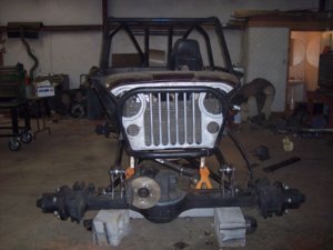

1946 Jeep
YJ frame, YJ tub, CJ front end, front raised slightly to clear full size car radiator. Some roll cage work. Front engine tubes and radiator hoop under hood. CJ automatic brake pedal assembly. CJ lower heater box, upper box removed and vent covered, for storage compartment.
1970ish 307 small block chevy (SBC) w/ swaped on TBI, custom TBI chip tuning by me. Aftermarket ram horn exhaust manifolds to custom Y pipe to 3" exhaust. Serp. belt conversion, York/OBA,
Front D60 - 4.56 LockRight. TSM Behind knuckle steering arms
Rear 14Bolt - 4.56 Detroit Disk Brake Swap, shaved bottom.
700r4 - Ill be rebuilding it this winter. JB conversion t-case adaptor/clock ring, cutom modified camaro floor shifter :)
D300 - JB conversion 4:1 gears. Stock outputs
Custom crossmember, tranny/t-case mounting, covered w/ 3/8" alum belly skid, with extra guards for muffler, oil pan and ebrake disk..
High Angle Driveline - D300 output e-brake kit.. and rear 1350CV 1410 on the 14b
+4" Alcan rear leafs, custom mix front pack..
Warn M8000 on custom lopro winch plate/front bumper.
38" TSLs on recentered H1s, and 36" TSL-Radials for the street.
Much more the average person will surly never notice.

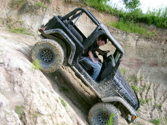

1974 J10
131â€WB
Chevy 350
SM420
Dana 300 twin stick
Locked D44s front and rear
4 inch spring lift in front shackle flip in rear
Ugly ass paint with non-matching passenger door
Too much WB, too little tire, looks like like grandpas fishing truck, but it’s fun to walk right over some of the stuff that stops little jeeps with bigger tires and open diffs.
Got a lot of other junk, but this is closest to a “trail rig†right now.
