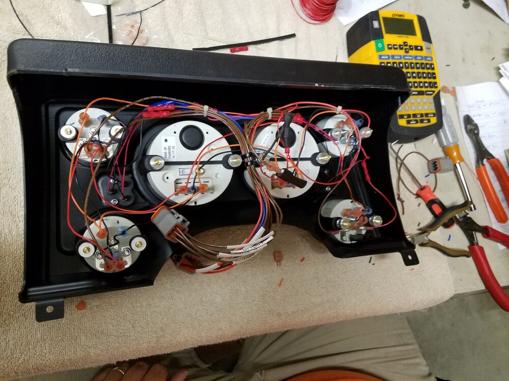

I wanna clean up the wiring and minimize it all I can. That's the main reason behind going digital.
I had a gas station cheeseburger today so I'll have plenty of poop time later to surf the options y'all posted
Everything wired into two connectors.
I will say on this build I'm going to do my best to make the effort to keep things nice and tidy. It very well may be my last real build.
