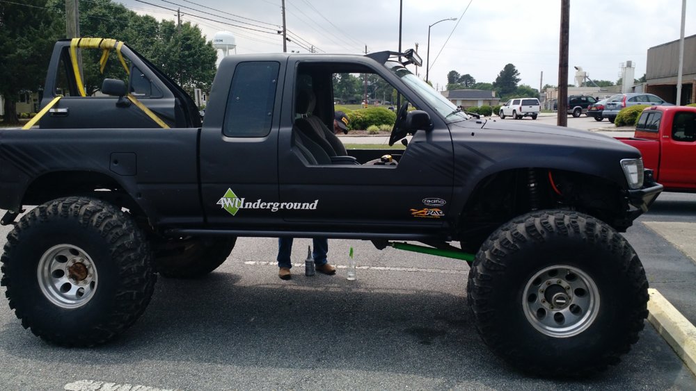

Any toyota IMO needs a budbuilt crossmember with at least a slight drivetrain lift. XCab trucks I prefer to flatbelly but that involves cutting the floor considerably in most cases. My old one on 36's and then 38's then tons and 42's got a workout on that crossmember.
