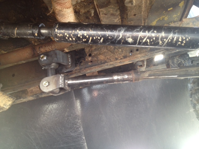

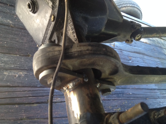

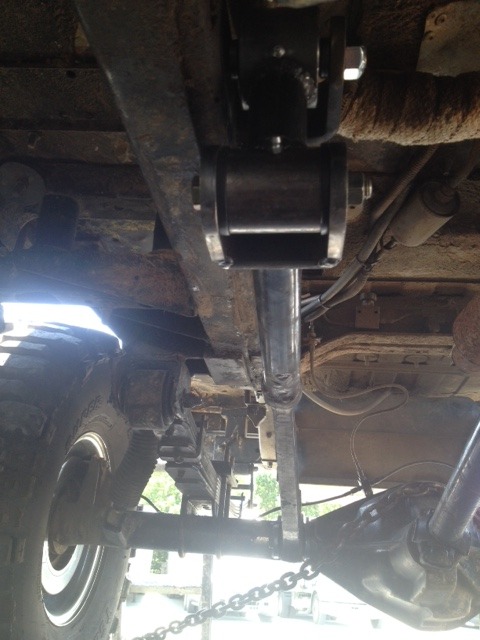

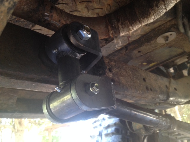

I used one of these. Attached it to the rear axle, extended it with some DOM, and built a small shackle for it to stop my wheel hop. Pics are on a dead phone. I'll post them up later

You wouldn't happen to have another of those links would you? I'm needing a traction bar, but not wanting to spend $200+ on a diy'er. How important is the placement of the shackle? Seems to me that it should be very close to being in line with the driveshaft u-joint.
Ideally you want it as far forward as you can place it
Right, and either your driveshaft (slip member) or yoke (slip yoke) would account for any change in driveline length, as usual. It doesn't have to mimic the line that the driveshaft takes. If the traction bar is too short it will cause jacking issues. There's another recent thread on here discussing that very problem.

I do not but a quick Google search will net you a company in Fla that sells them. You may find one in a junk yard if it has Rovers. I paid $100 for it and got the rest of the parts from Ruffstuff and a Johnny Joint from Moser. Just search for Land Rover radius arm. I just made it longer than the springs as far up towards the transfer case as I could and put it there.
