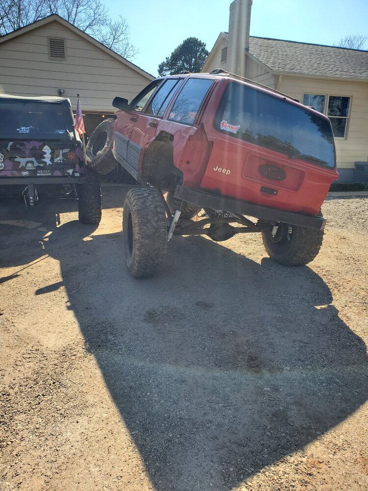

My current rig is just a ZJ with welded axles, grooved 37s, doubler, 4link/3link. nothing fancy, it's actually mostly built from customers/friends leftover parts LOL, so it's more like my community built rig. Everyone has a little piece in it. A friend just donated a dual ended ram for it, another buddy is donating a PSC TC Pump and resi. The only part I built tough is the doubler (can't cheap out on that otherwise it won't work/hold up properly) and my driveshafts are stupid beef (ghetto but strong as crap). Everything else is kinda pieced together with this and that, no fancy work basically. I've got about $900 in it but dam it performs really well for being just that...Oh and working Heat and AC!! :D
But soon I will have Chromolly shafts and some expensive ball joints. I've already done the knuckle gussets, arms are drilled and double sheared on both sides with 7/8 heims as well. So within next few months, front will be pretty bulletproof for 37s and deal with rear later haha.
I'm not in a hurry to go Tons cause it honestly does so well I hate to change anything on it, it flexes amazing for it's current setup and just downright works so I'm not changing anything.

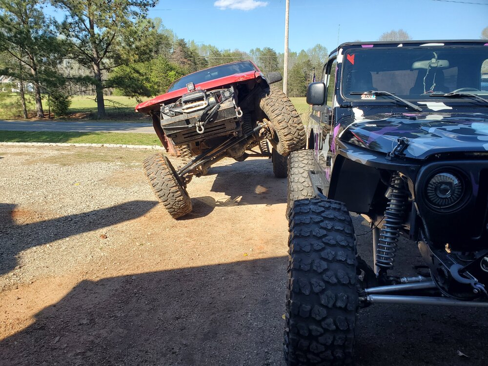

This is 10inch shocks and still has tiny bit to go..not bad for 900 *hitbox lol (his are 40s).

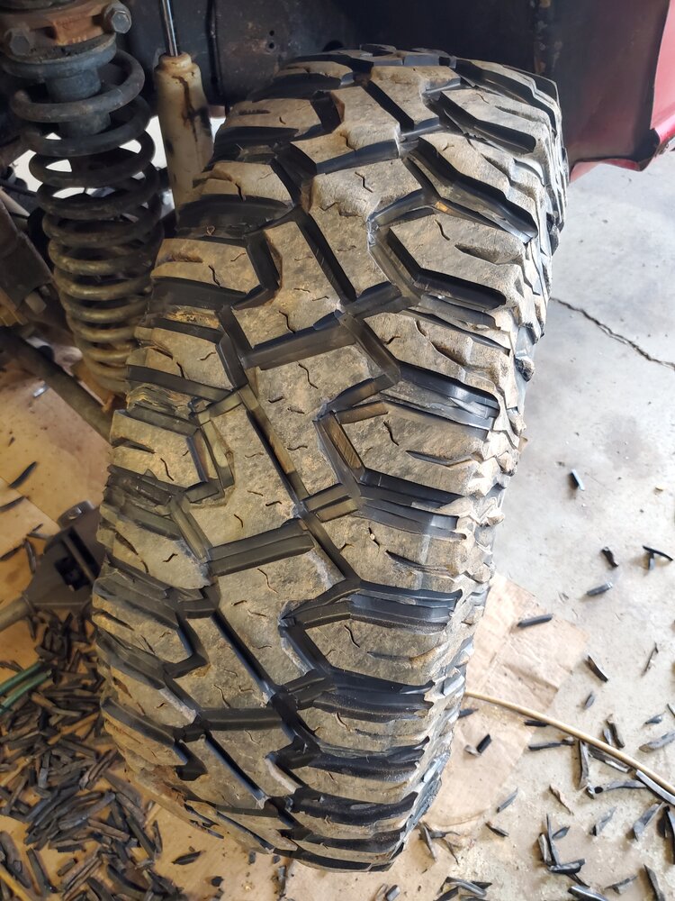

Them Patagonia are killing it now hehe
Yes that's a trussed and 4linked Dana Turdy5 lol (somehow I've broken 2 sets of normal ball joints and 2 front shafts but rear is holding up welded completely to itself hehe)
