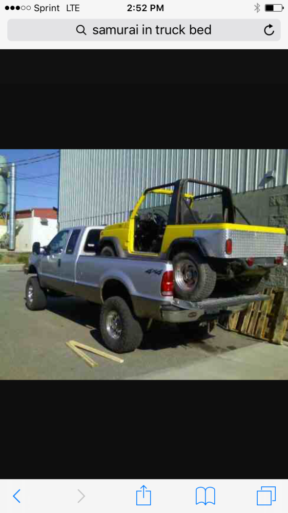

I already have an '82 Toyota buggy, but wanted something small and low that I could bang around in the woods with, and take to the trails when the Toyota is out of commission. The appeal of being able to fit it in the back of my f250 was also a factor.
