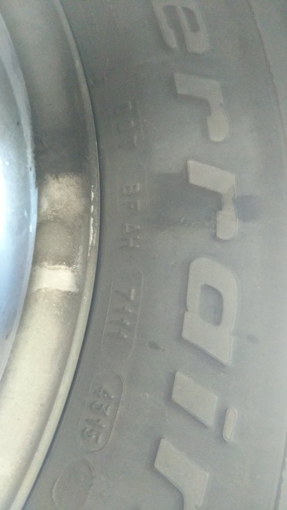

I have a set of BFG KO2s with a 7111 date code. All four are the same. My understanding was always that it was numerical week of the year, then last two digits of the year. KO2 didn't come out until 2014, so that makes no sense.
Not enough numbers there. One side usually just has the dot xxxx zzzz where xxxx = the plant and size and the zzzz = some other code (my bfg book says its a code that goes into more detail about the size and spec of the tire.)
The other side of the tires dot code will usually read dot xxxx zzzz wwyy with ww being weeks and yy being year.
Long story short, one side doesn't always have the date the other side does. Check both sides. Lots of tires will have the full dot code on the "ugly" or inside sidewall.

Well, there aren't 71 weeks in any year, so you're looking at the wrong number.
That's what I'm saying. But I have another set of KO2s that have the correct number in the same spot on the tire.
I'm going to check the other side and see what I can turn up.
