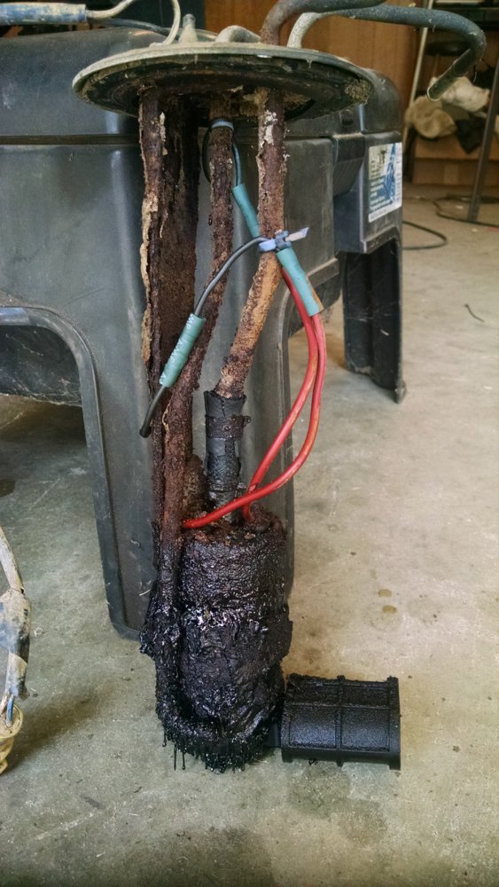

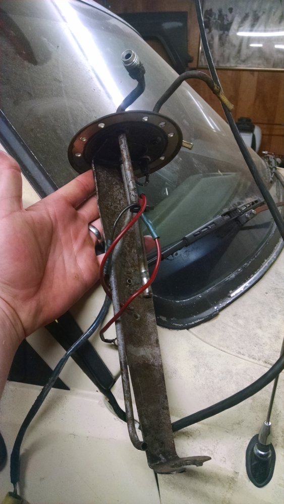

Omg holy crapI tested back to the fuel pump with the jumper and I'm showing 12v at the plug but the pump isn't pumping. Any clue what I should do next?View attachment 253548
