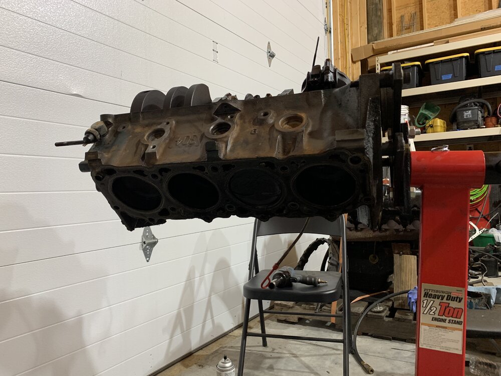

Well finally got a com and lifter kit in! I tore the motor down yesterday and found that the cam bearings have failed, so I turned the motor over and pulled the oil pan to find a rag in the pan stopping up the pickup. I guess the shop the PO had do the rear main was nice enough to leave it. So I checked the crank bearings and it’s not good. Guess it’s time to look for another engine. If I didn’t have bad luck I wouldn’t have any at all

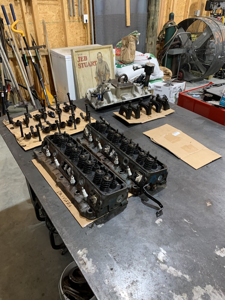

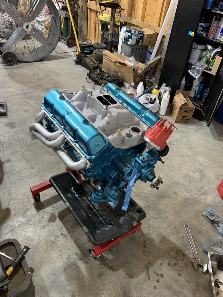

So after going back and forth on what to do with my burnt up engine I just decided to chalk it up to a learning experience and do a full tear down and rebuild myself. I hope it runs!

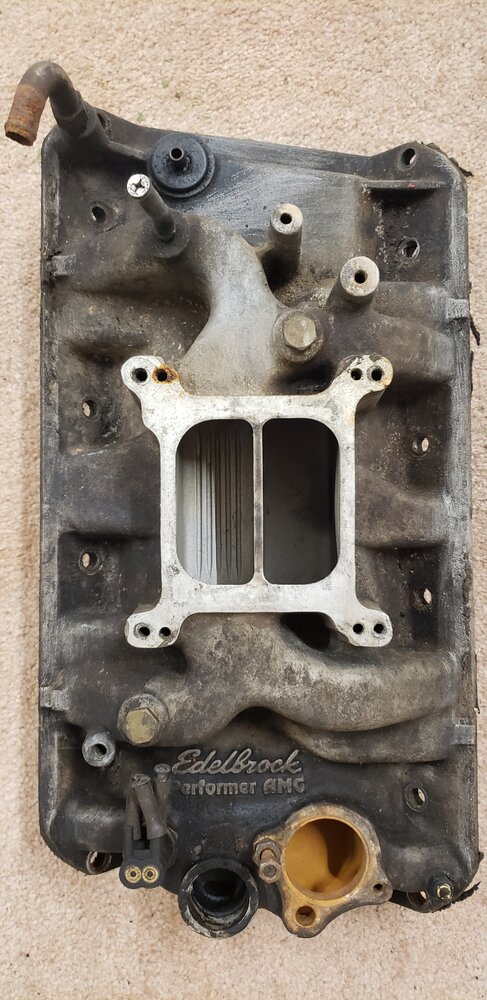

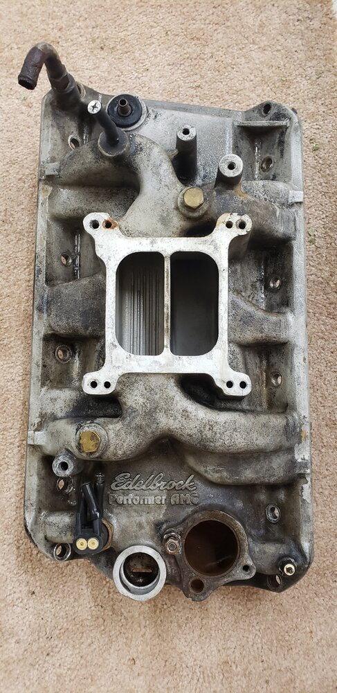

@Hulk72 Forgot to ask what you did to prep that Performer? Sand blasted? Soda blasted?
Got one for my 360 that appears to have been boiled in crude oil for a few 100K miles 🙄 ... don't need "show quality", but wouldn't mind if it looked better than the crusty cast-iron intake it'll be replacing ;)
I used mag wheel cleaner on my 258 al. intake
I ended up media blasting it at a buddy's race shop. He wanted to powder coat it silver, but I figured I would roll with it the way it was.
