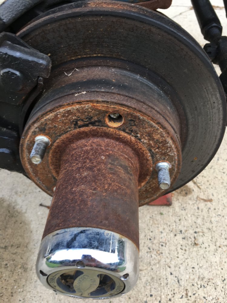

Where is the best place to buy replacement axle parts? The splines are stripped on my D44 wheel stud. I went to put on the tires and the wheel stud just fell out.

Put it back in and tack weld the back.
They are only a couple bucks at any parts house, so whoever has them in stock is where I'd get em.
Thanks! I thought about just welding the backside of all of them. I’ll check out the prices for replacements first.
Might as well get some new rotors while you're at it...and pads....and repack the wheel bearings.... :D
