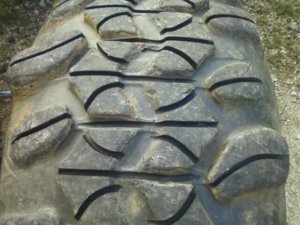

My old 42's. Just the standard lug cut through the middle.
I'll probably go with this pattern on my next set:
Those are not mine.

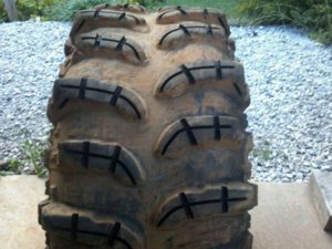

My TSL's my yota are like 'drkelly' above, but I turned the blade upside down and siped the inner and outer lugs about 2/3 the width from the interior of the lug outward...that helps keep the outer lugs from chuncking off. Seemed to help some I think because the larger outer lugs weren't quite so rigid...
