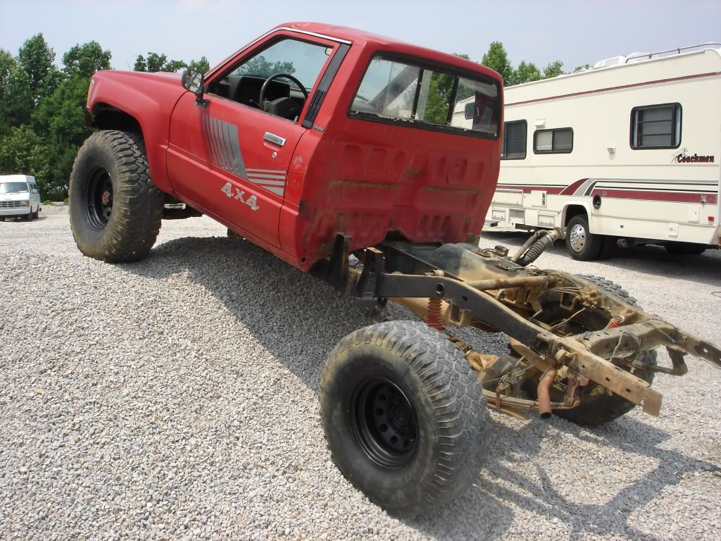

I'm trading my Conquest tsi, The guy has a 83 yota pickup with a full exo and no bed or doors, or a 87 pickup with no bed but no rust. I know the 83 has the soild axle but the 87 has efi. Help me decide
