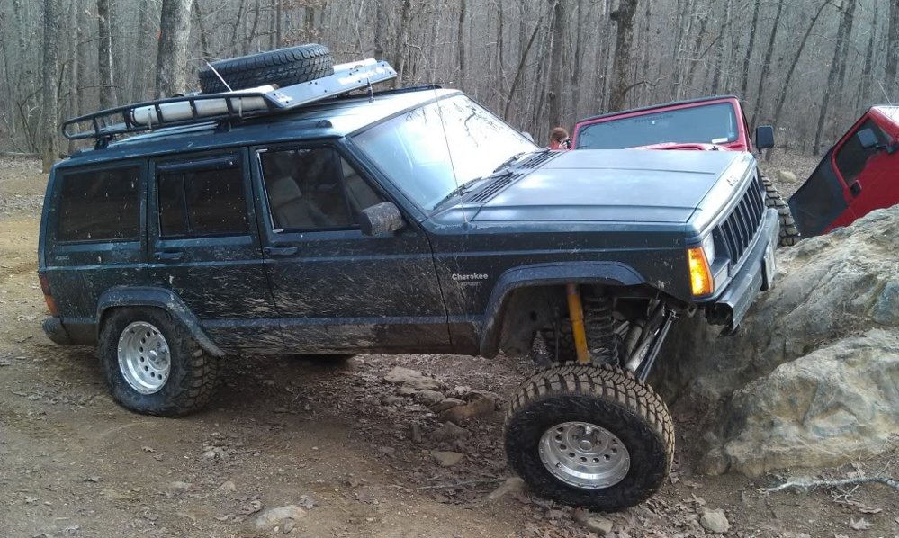

I ran 31x10.50s on 15x8 with around 3.5" backspace on my old xj with 4" lift and still had to do a lot of trimming. I had it set up for lots of up travel though.

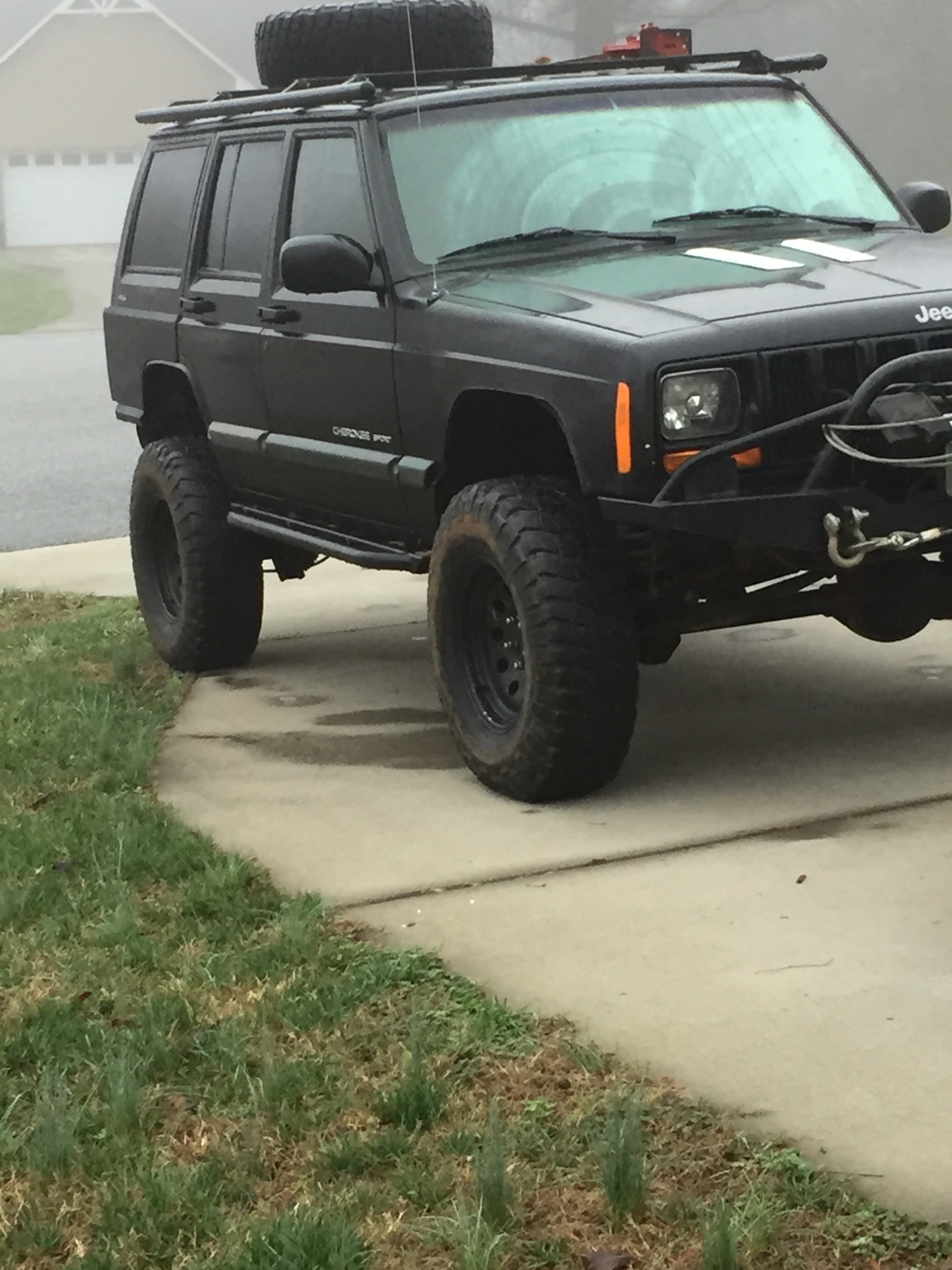

This jeep is 4" lift with trimmed fenders.

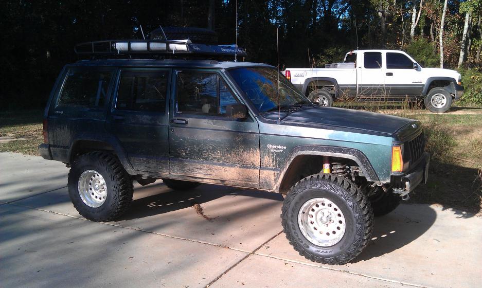

I have a 4.5in lift on mine with trimmed fenders. It has 33x12.5's with 2.25in backspacing. It gives it a wide stance and you can self spot a little since you can see the tread while driving. Sorry the pic isn't that close.
