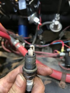

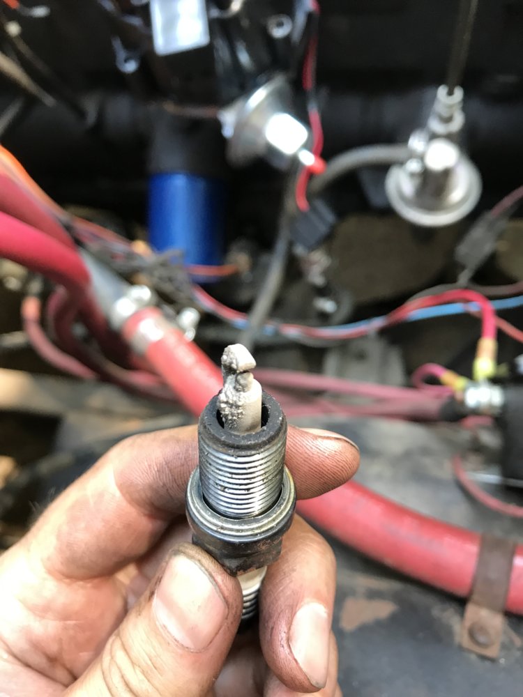

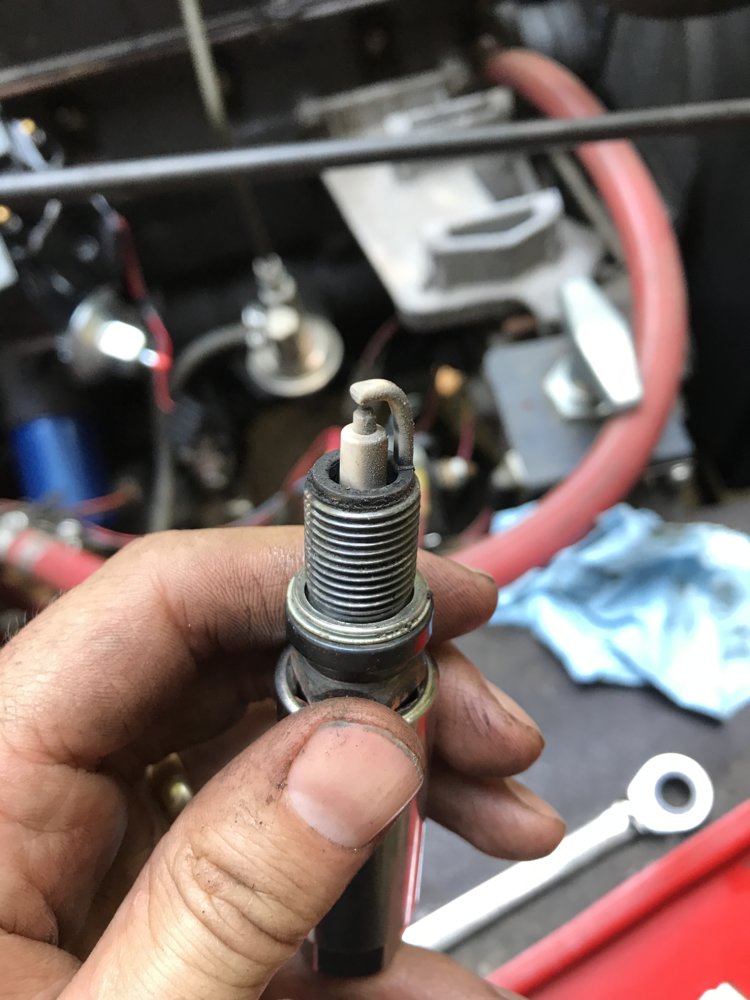

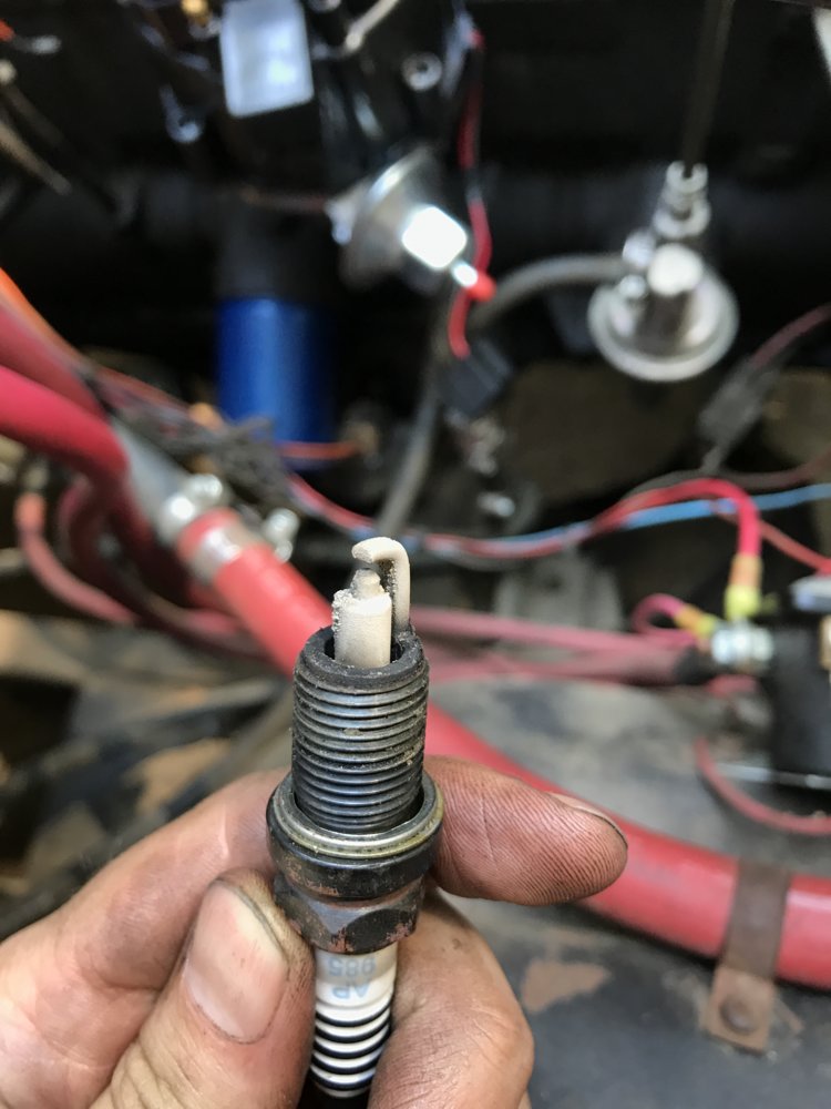

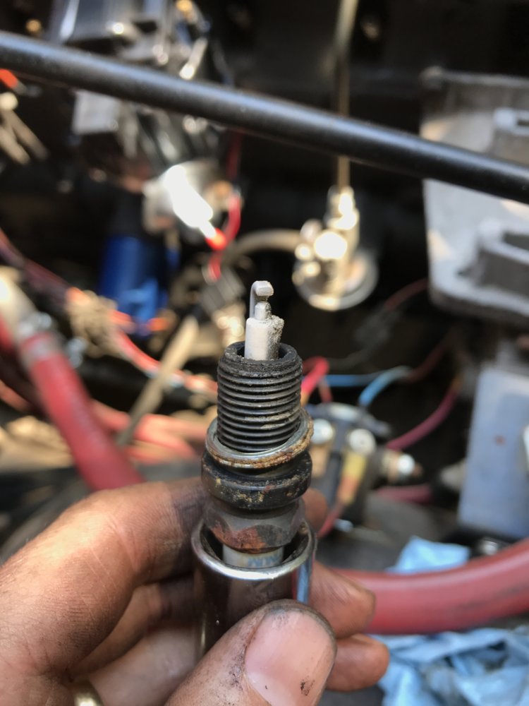

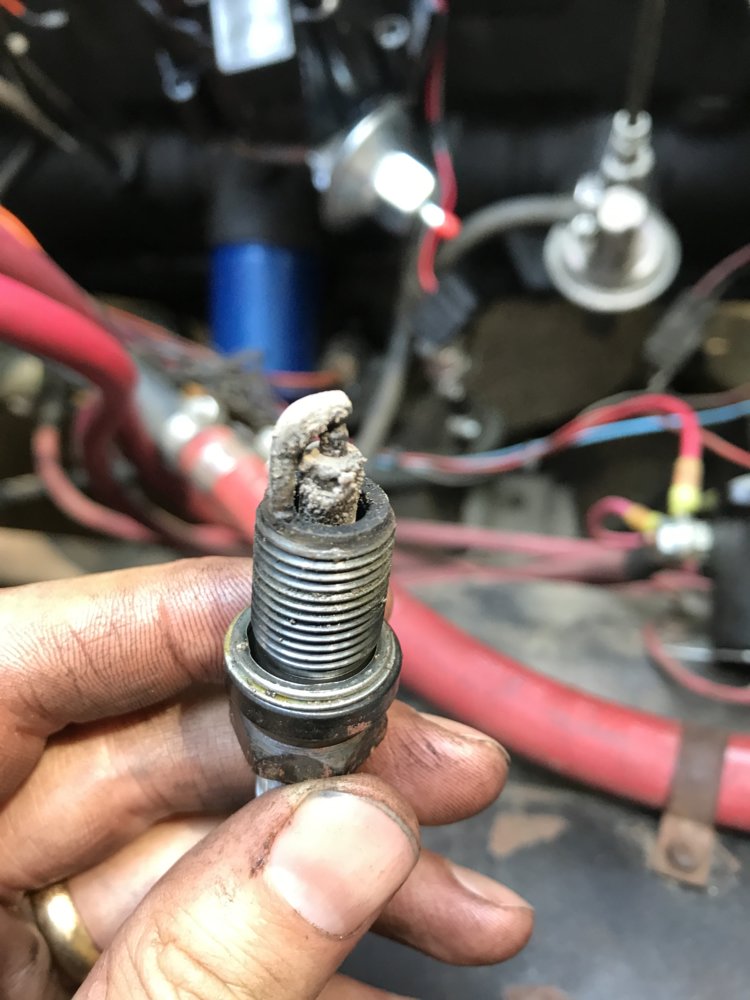

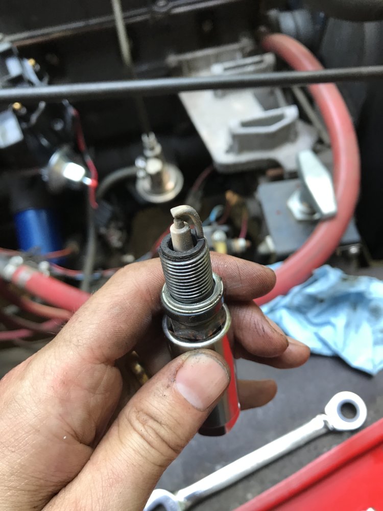

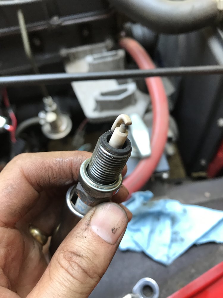

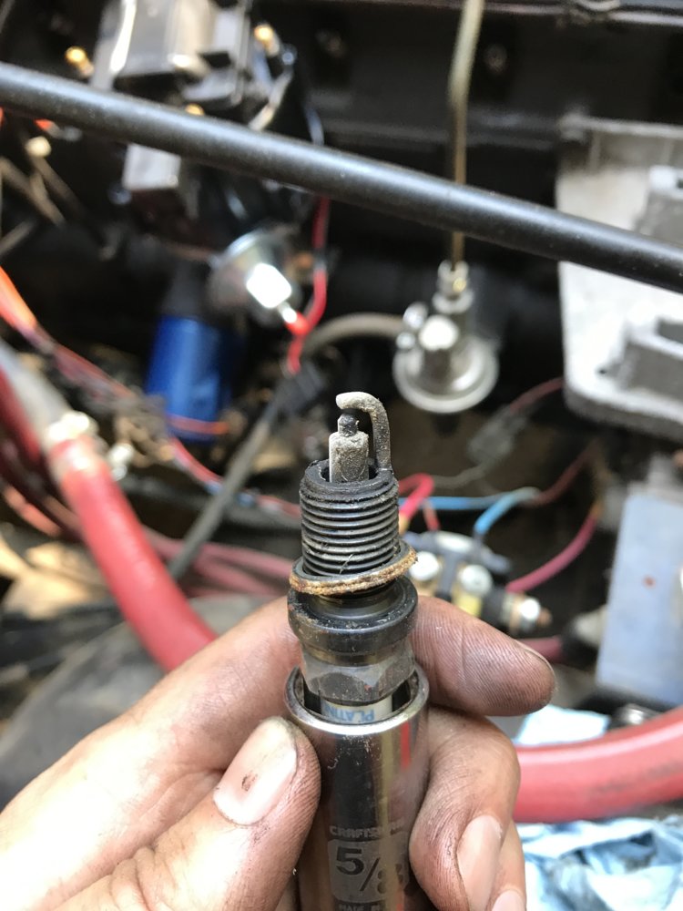

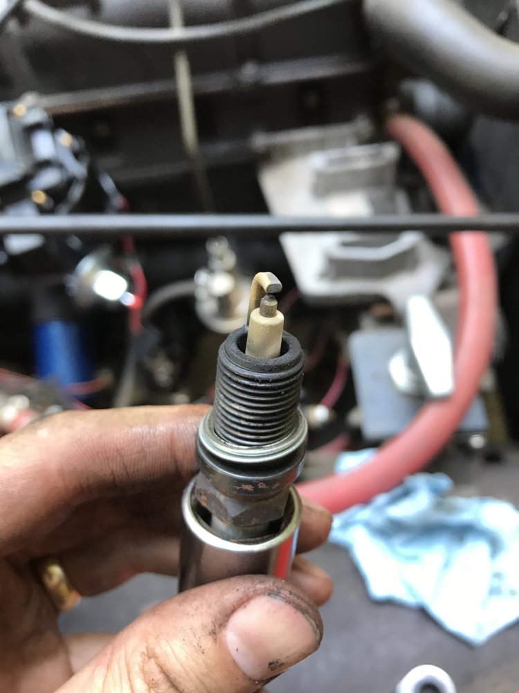

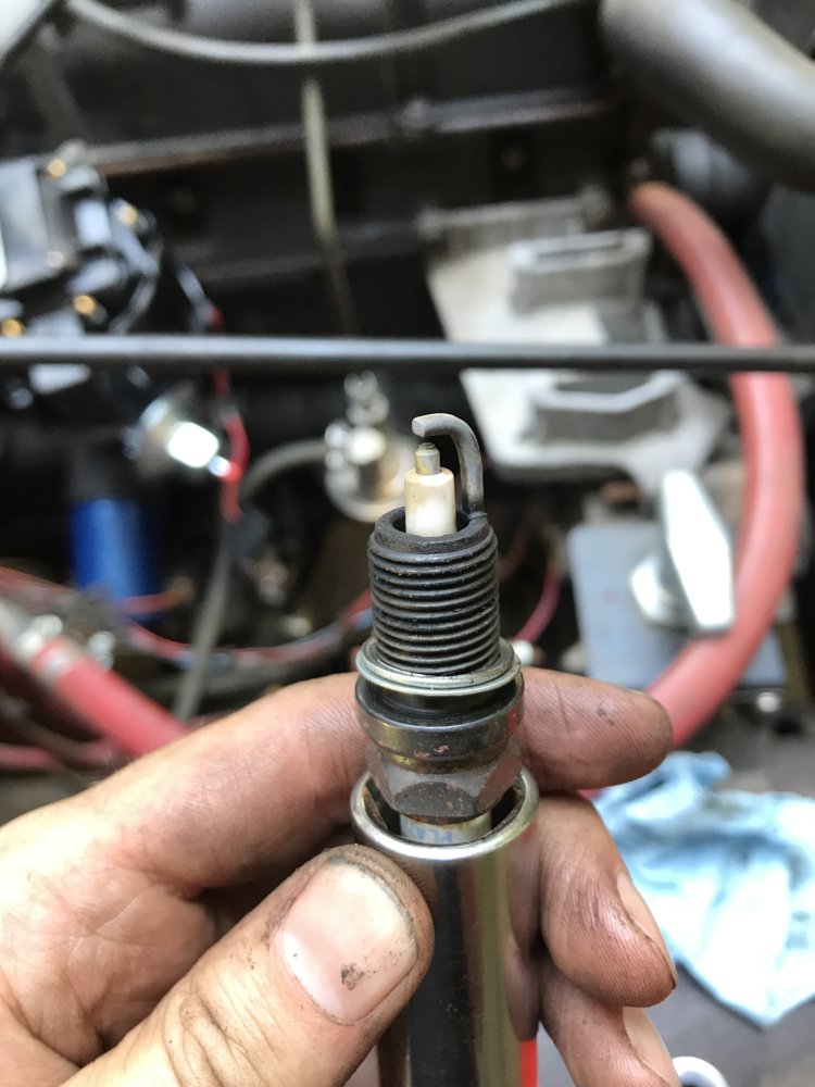

Pulled the plugs today on the 4.2 and there was a fair bit of ash build up on them. Is this from running too lean? I JUST went through the 2150 and cleaned as one of the squirters was clogged.
I think I got these in order:
Plug #5
#4
#3
#2
#1

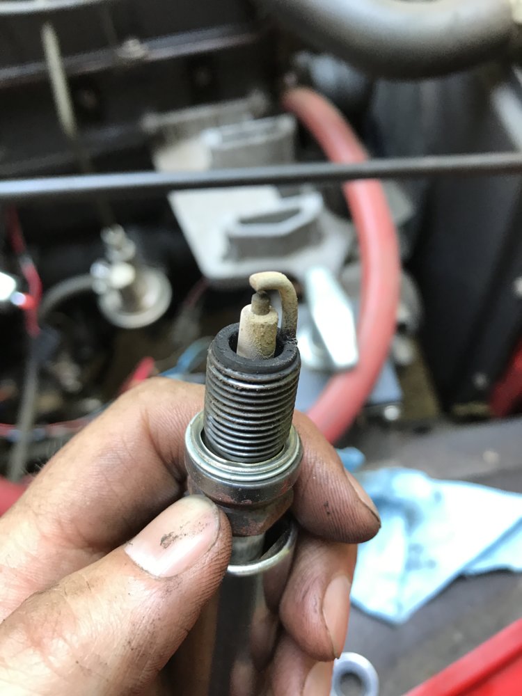

I did not get a pic of 6. I started at six and worked forward and it was perfect looking.
The light colored ones look lean. The ones with the heavy, chalky deposits are most likely poor fuel, fuel additives, and/or oil in the cylinders with high temps. Try fresh fuel, check for vacuum leaks/go up in jetting, try different heat range (colder)
Hmmm. Poor fuel could be an issue from it sitting for a few months, especially during the rain.
The lean condition is funny as I've always thought I was over fueling. I'm already running .50 jets, where most people run 48s or 49s. PV is an 8.5 too which is a little bigger than most.
2 3 and 4 look fine.
I would compression check 1 and 5. Also check the wires and cap and rotor. Deposits like that are usually misfire.
Plugs should be a ashen brown when all is good. If they are pure white then you are lean and running hot. Dark brown is rich and a bit cold.
Here is a good link Reading 101: How to Read Your Spark Plugs - OnAllCylinders
