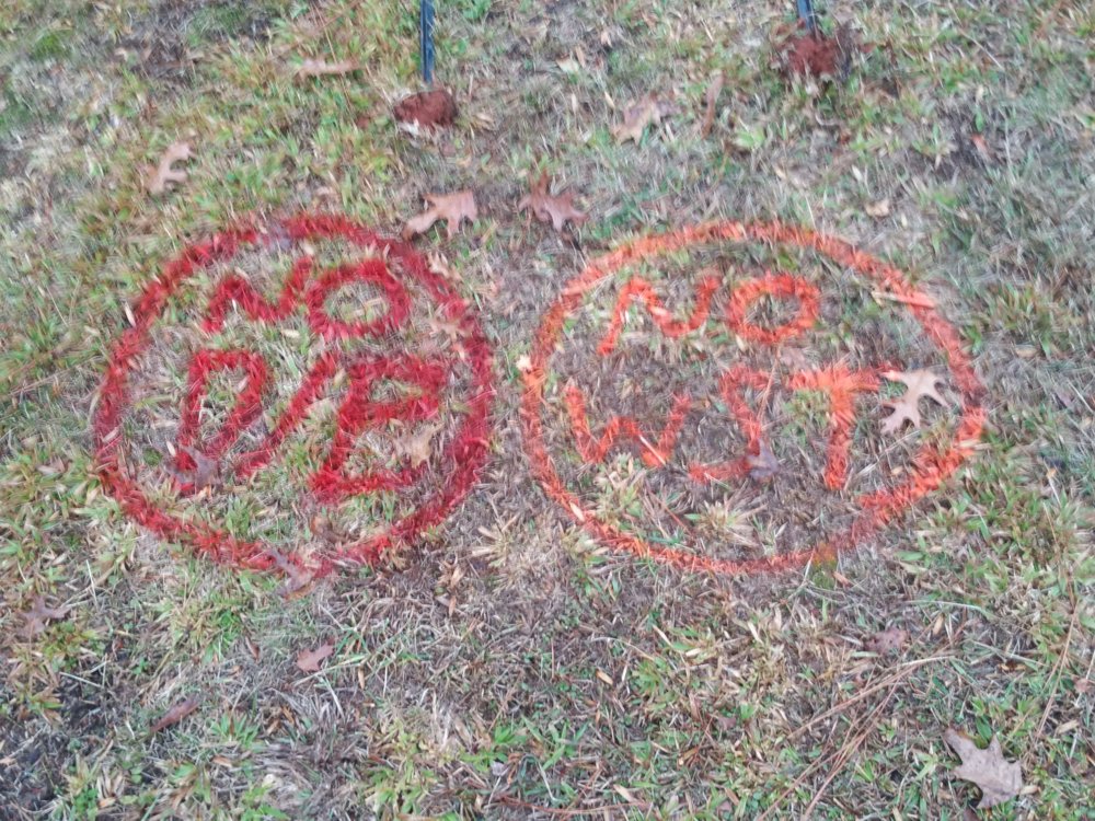

What do these mean?
No duke energy
The orange will be for telephone or cable tv not sure who the supplier is there
Windstream. Makes sense. I assumed it meant "no waste." I think the lot won't perk. It went up for auction last year. Somebody bought it for too much money. Now he's trying to sell it for way too much money. I'm trying to lowball just to keep it an empty lot. Maybe put a shop on it or something.

Red is power
Yellow is gas
Blue is potable water
Orange is telecommunications
Green is sewer or drain lines
Purple is reclaimed water/irrigation
Pink is temporary survey marking
White is proposed excavation
