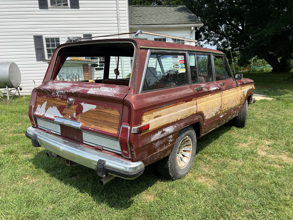

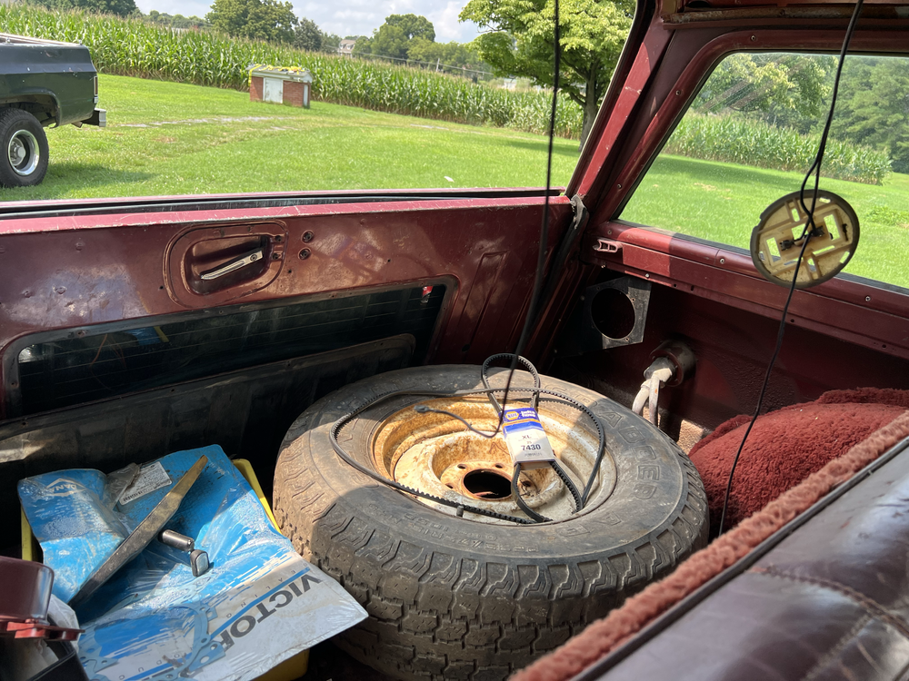

For some reason I decided I don't have enough projects (1902 House, 77 CJ5, 86 K10, 87 Mustang) and picked up this OK condition 1985 Grand Wagoneer that had been in the same family since new. Albeit with decaying condition in recent years.
158,000 on the dash, 360 with factory AC (underhood parts gone, interior parts there as far as I can tell right now) PW, PL, PS.
The engine:

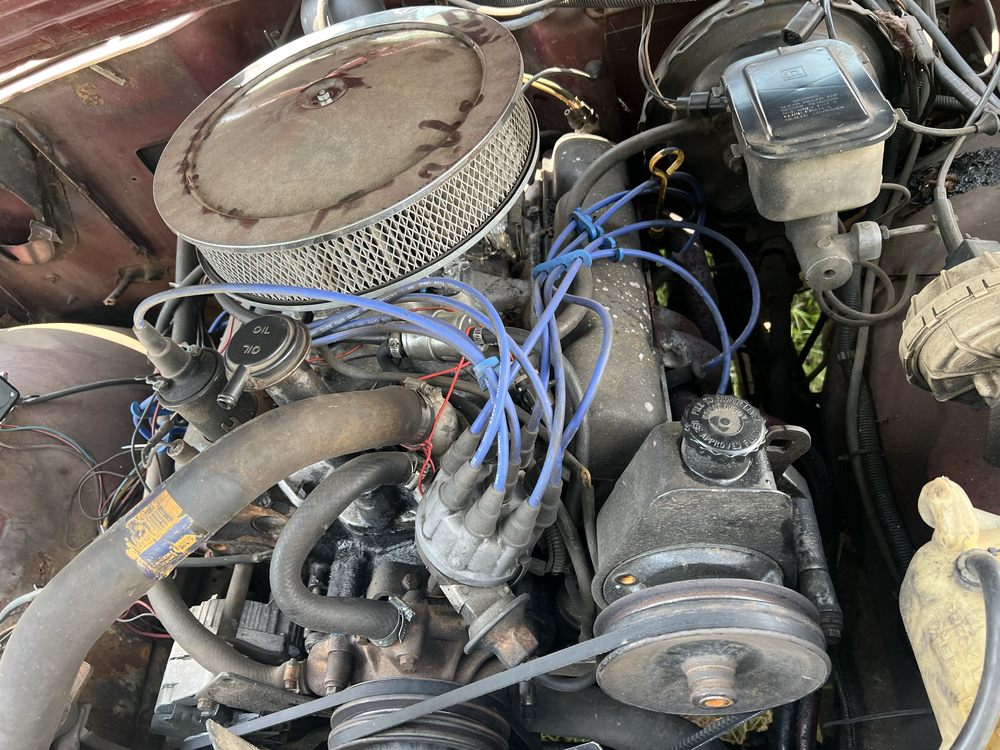

- 360 w/HEadman Headers, Edelbrock 4bbl intake and 600cfm carb
- Belts were all loose, tightened everything up and it runs smooth.
- Takes a good 30 seconds to build oil pressure.
- Oil leaks, lots of it showing on the front of the engine.
- Exhaust leaks (header bolts were finger tight) so I am waiting on new gaskets to see if I can quiet it down before I drag it to an exhaust shop.

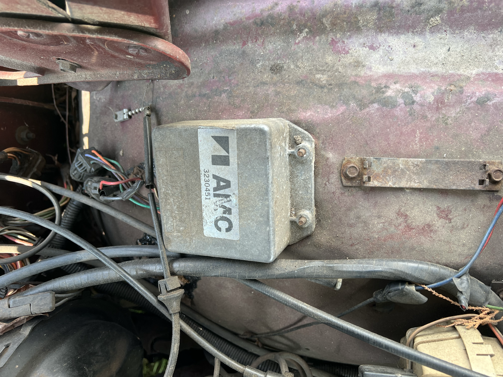

- Ignition box has a line of tar running down the inner fender
- New starter.
Exhaust:
- Leaks bad, gasket clearly blown out, bolts were finger tight
- No gasket/donut at the header to exhaust pipes
- Blown holes at the hanger locations
The transmission:
- Shifted ok test drive.
The body:

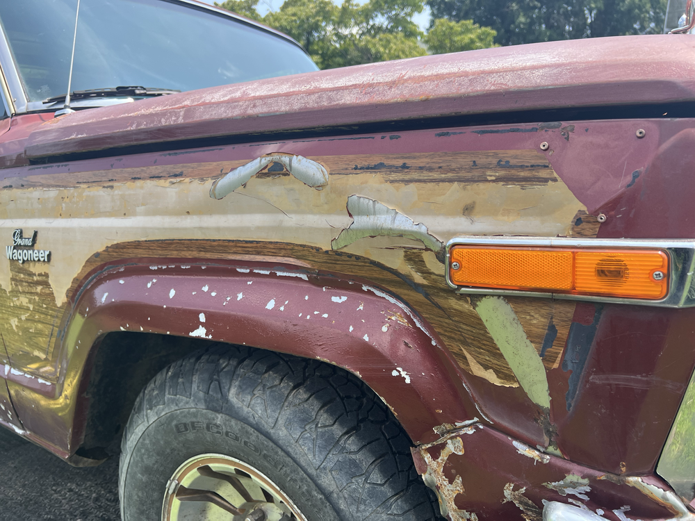

- Pretty solid but faded
- Rusty passenger rockers

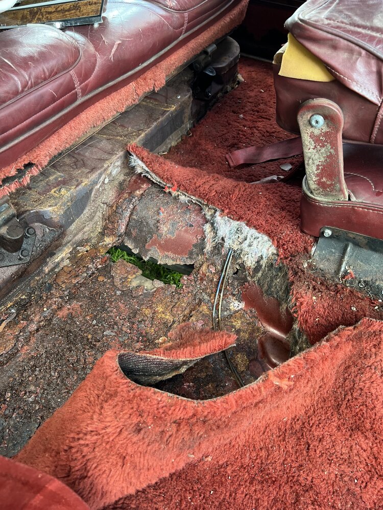

- Rusty floor pan in the back at the corner of the door and seats
- Couple holes in cargo area floor
- Passenger side dented
- Little but of driver door sag
- Weatherstripping shot everywhere but rear windows
I'll know more once I get the seats and carpet out and start intervening on the rust progression.
The interior:
- Carpet shot, and wet
- Front windows don't work, passenger one pushes up and down by hand
- Electrical wires everywhere, missing relays and rusty relays.
- Few house wire nuts and way too many scotch locks
- No headliner
- Door cards rough
The rear:
- Back glass is stuck down
- Tailgate is stuck on the passenger side
- Missing the "chrome" trim around the back window
For the money I think I did ok. It will be a rolling restoration.
The questions:
- Do I switch to HEI?
- What weather strip package do you guys recommend? Piece it together or buy individually?
- Will I be able to find the heat/AC parts?
- Any suggestions and recommendations are appreciated as we just wanna drive it as we fix it up
- Advice on the tailgate?

Heard on TV the other night, a discussion of what was your first car? One guy was telling of his with rotted floors, & he just had carpet over the passenger floor. His girlfriend get's in to go for a ride, & a ways down the road, she lost a shoe out the floor! :laughing:
That was my $500 XJ when in college !!! lol
Luckily the shag carpet didn't give up on me and nobody ended up through it haha
My yj I had in highschool and college was the same, drivers floor totally rotted out. I slapped a rubber floor mat over it, eventually it got a license plate/bondo repair.
