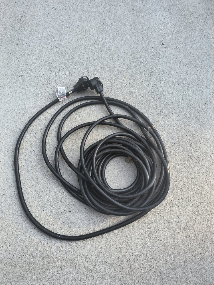

This reminds me.. I have a 50ft chord I need to get rid of (30 amp)
