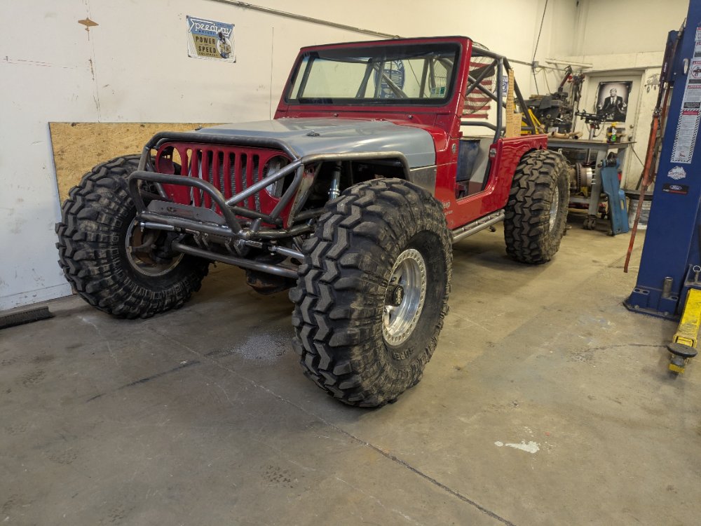

Picked up the roller a couple weeks back. The hung the engine trans, case, trussed and linked the axles and added 14" Radflo coilovers. I'll be documenting the rest. The list is long for sure but I saved and will reuse a ton of parts from my old Ranger.
Specs: 306 long rod SBF, Fritts built C6, 4.3 Atlas, HP 60, 14 Bolt rear, 43 stickies. Wheel base is 118", weight is yet TBD. I'm thinking around 4400 w/o me.
If the build stays on budget, it's getting a whole new color. If not, it'll get a quick and dirty coat of TJ red.

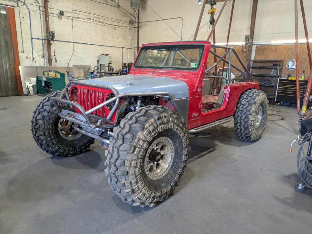

At WOD on pick up day

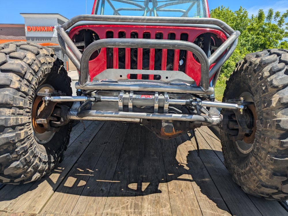

Front shot of steering and truss
Initial to do list
As it sits now with radiator mount fab as job #1

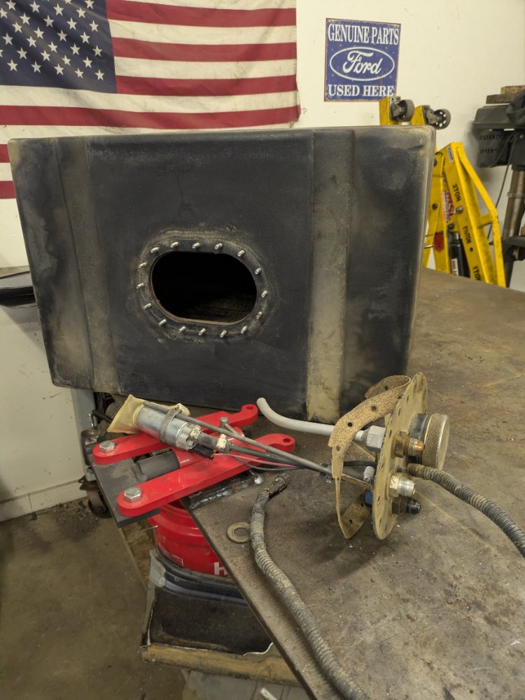

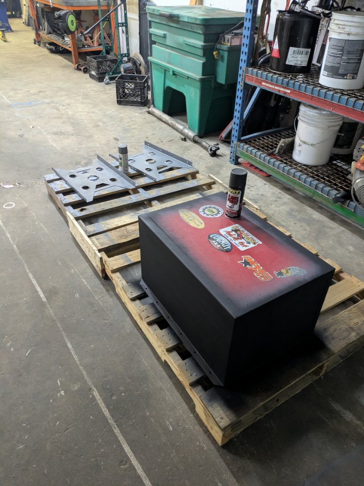

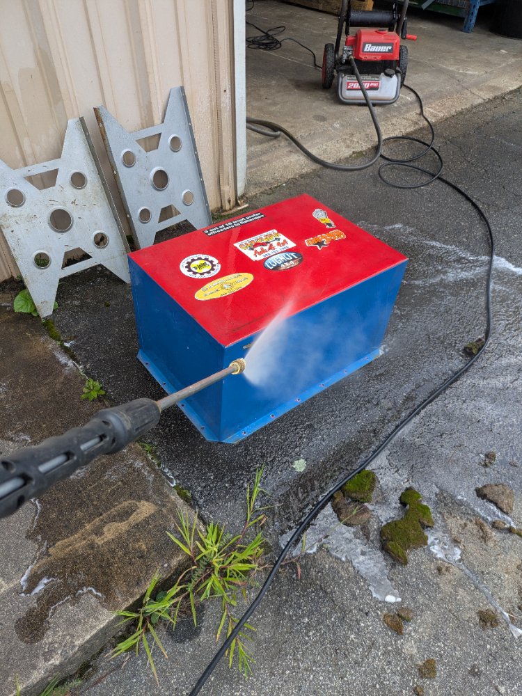

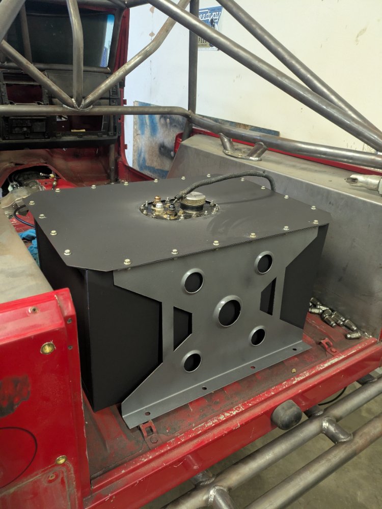

Stripped down the fuel cell yesterday for new paint and a good cleaning. Replaced the pre-filter, cleaned out the cell and threw a few coats of flat black high temp paint on the cell.
Why high temp? Because I'm cheap and Advance had cases of it on clearance for $1 a can earlier this year.

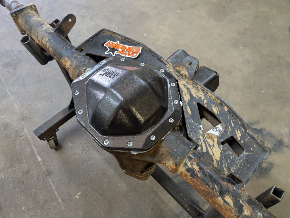

While paint was drying, I installed some 5.38s and new bearings in my old 14 Bolt from the Ranger. Local kid is putting it in his XJ.

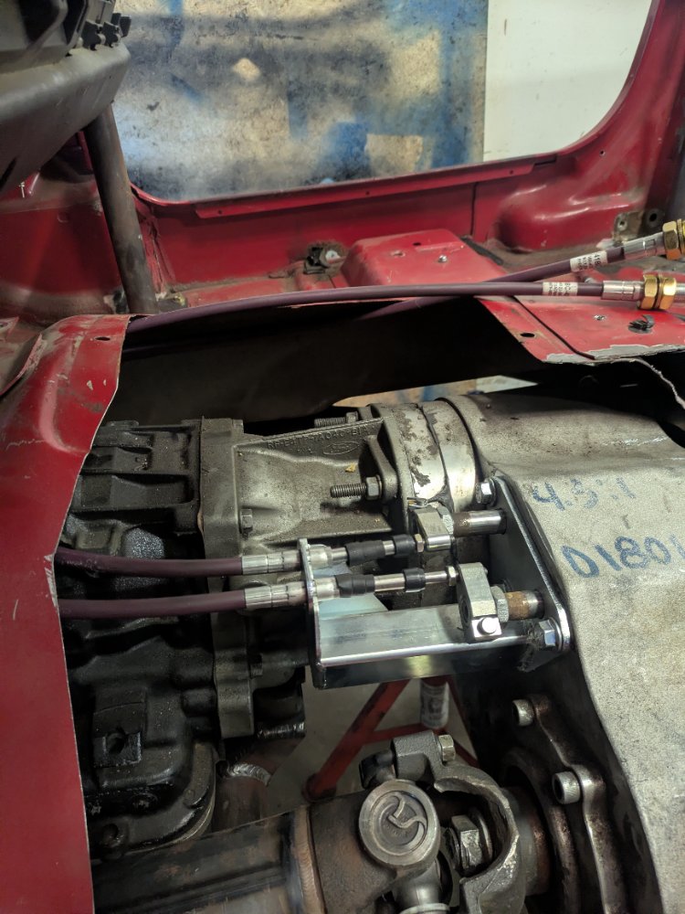

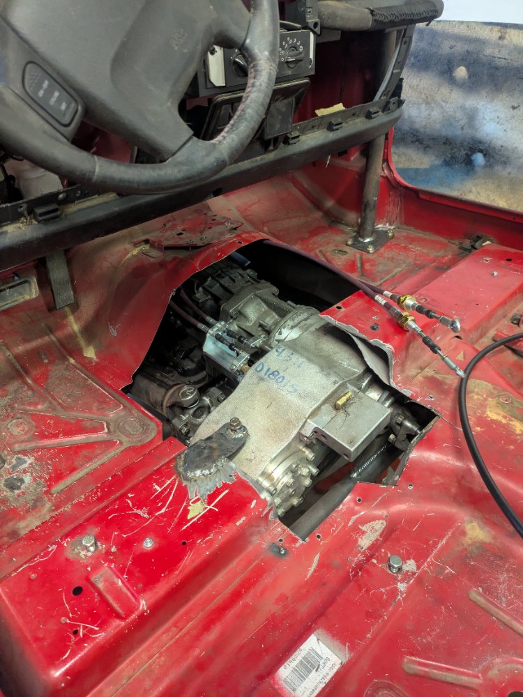

Got the Atlas cable shifters on and mocked up to the Genright console. Started doing the same with the Winters C6 shifter. But the driveshaft and cable want the same real estate. On my Ranger, it was similar and I routed the trans cable forward around the oil pan, up the pass side of the trans, to the shifter. But the exhaust continually compromised the cable. That being something I'm not doing again, back to the drawing board there.
Went ahead and reassembled the fuel cell in preparation of deciding exact where it will bolt down.

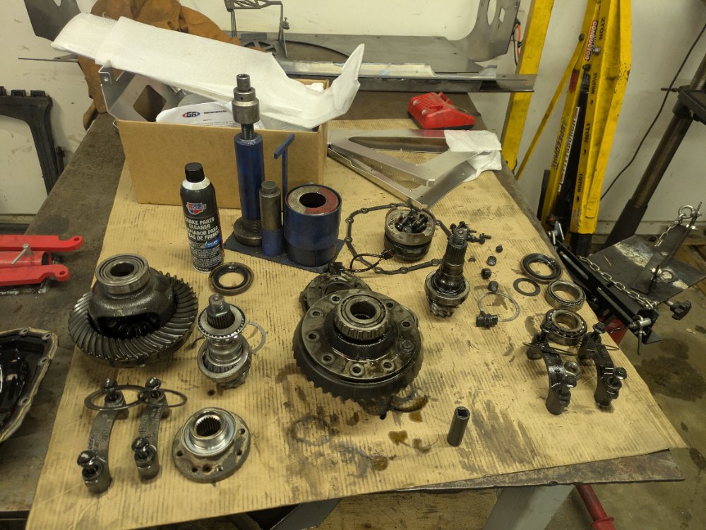

Sheetmetal fab sucks. So I decided to tear down a JT I'm gearing, adding a front E locker and RCVs and some trusses to this week. I can do that stuff without pissing myself off.

does your atlas have a tapped hole for a stud on top? the sheet metal tab has me confused for purpose, jumps to the passenger side?

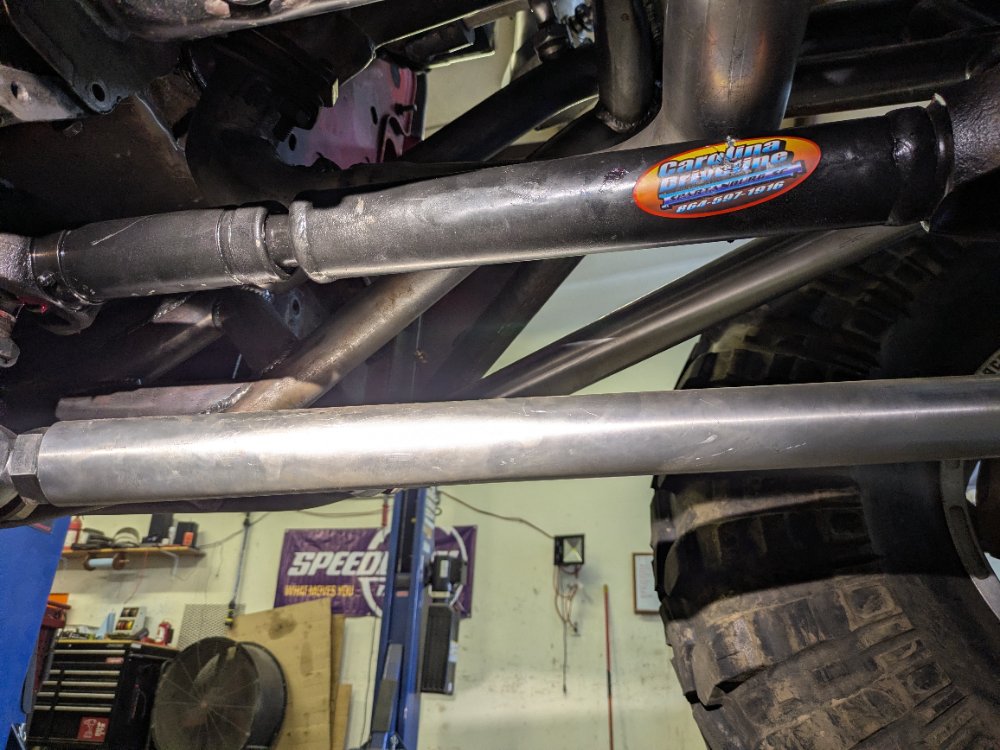

What size driveshafts you running?
It's been an incredibly hectic last few weeks. As a result, pretty much zero shop time aside from equipment at work. But today my wife wasn't in the ER and we didn't have a truck broken down.
So...

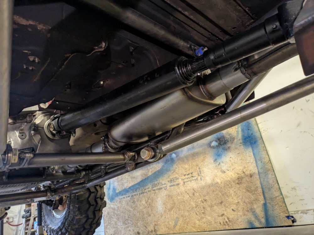

Got my Carolina Driveline driveshafts installed and cycled. The front clears the exhaust by the thickness of a sticker. For a hillbilly like me, that's impressive. Rear shaft installed so I can make a mount for the transmission cooler. It's gonna live in the space underneath the tub above the shaft.

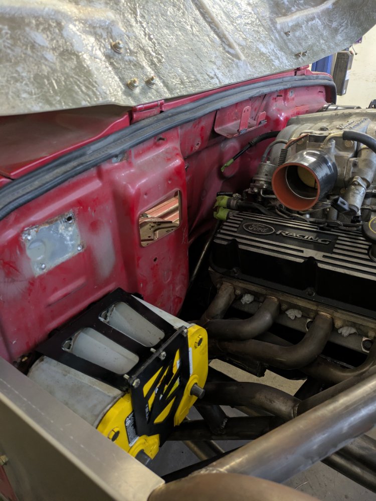

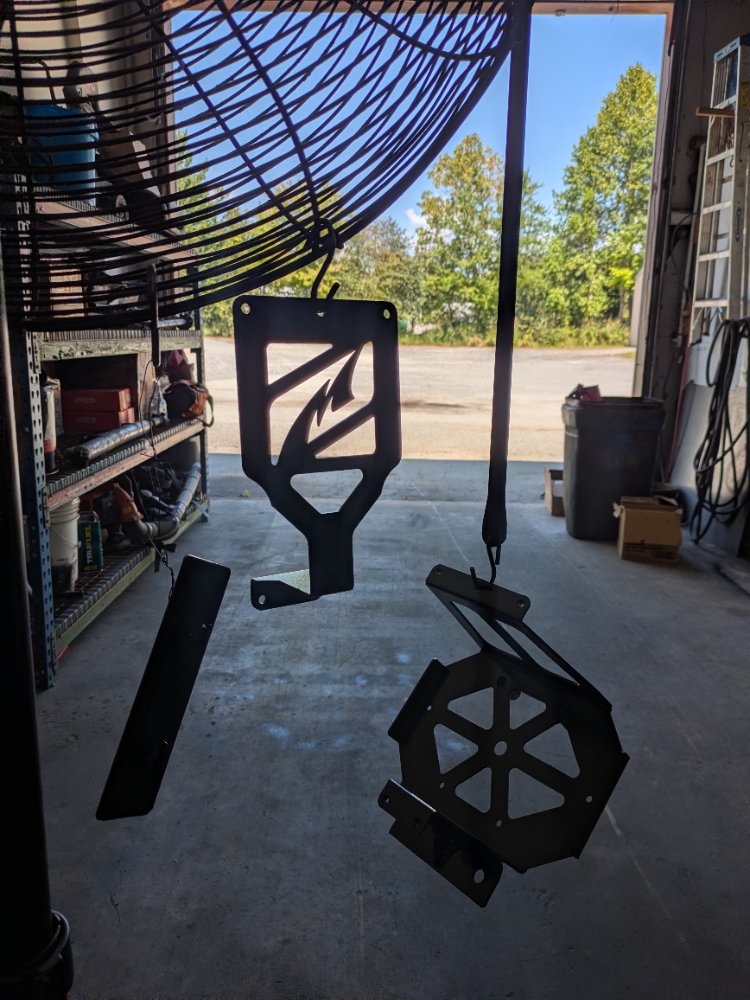

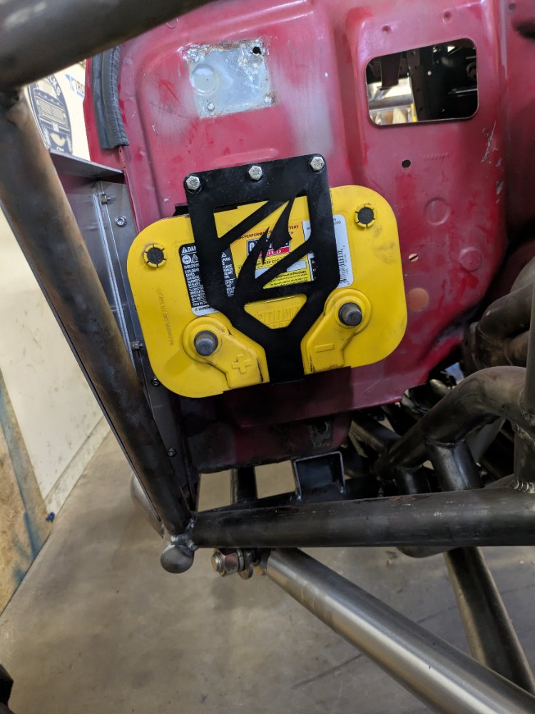

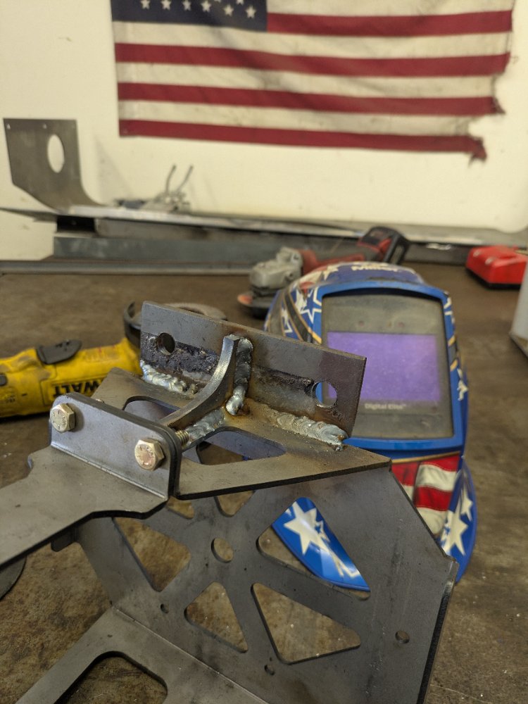

On to the battery box. I grabbed a typical Optima style battery box from Motobilt. I want the battery under hood and near the OEM location. That will keep power runs shorter as well as more storage space. These don't have any mounts so I welded on a 2 bolt plate with gusset for the bottom and through bolted the top with a sandwich plate inside.
There will be a MAF mount coming off the top of the box and the air filter will live over top of the battery.

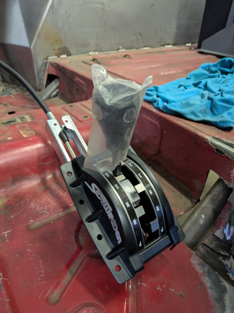

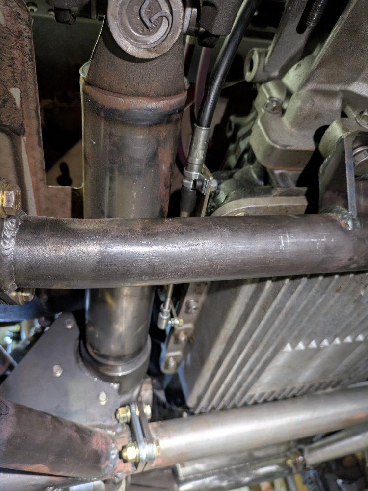

The transmission shifter cable and the lever and mount were going to be a clearance issue. I was able to cut and reweld/clock the lever and get the cable installed. There is a less than 1/8" between the mid shaft and the lever hardware in low gear. But having a solid mounted drivetrain, if it clears, it clears.
Atlas and trans shifters are ready to install once I assemble the console.

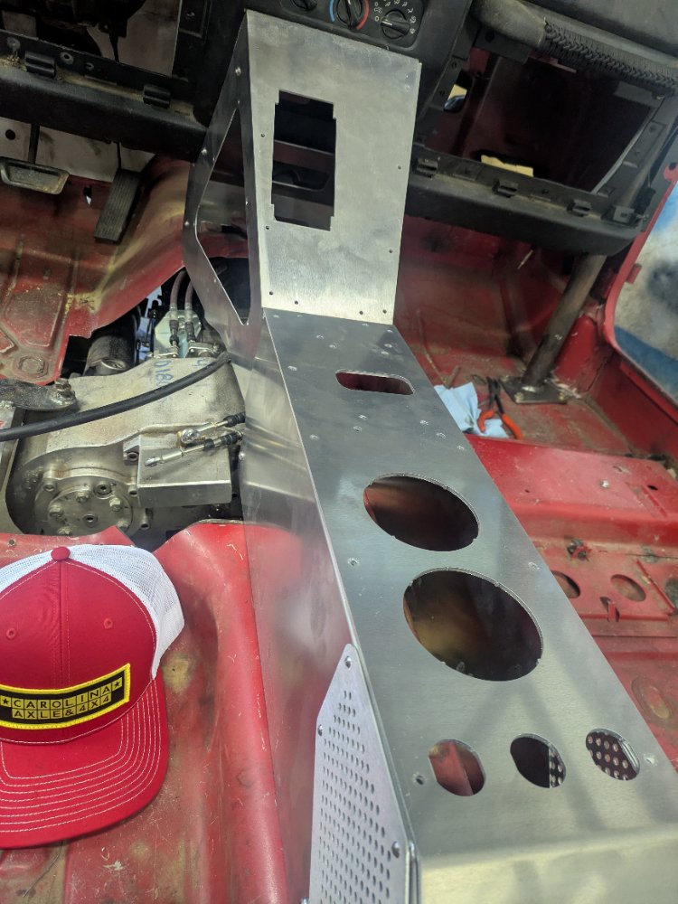

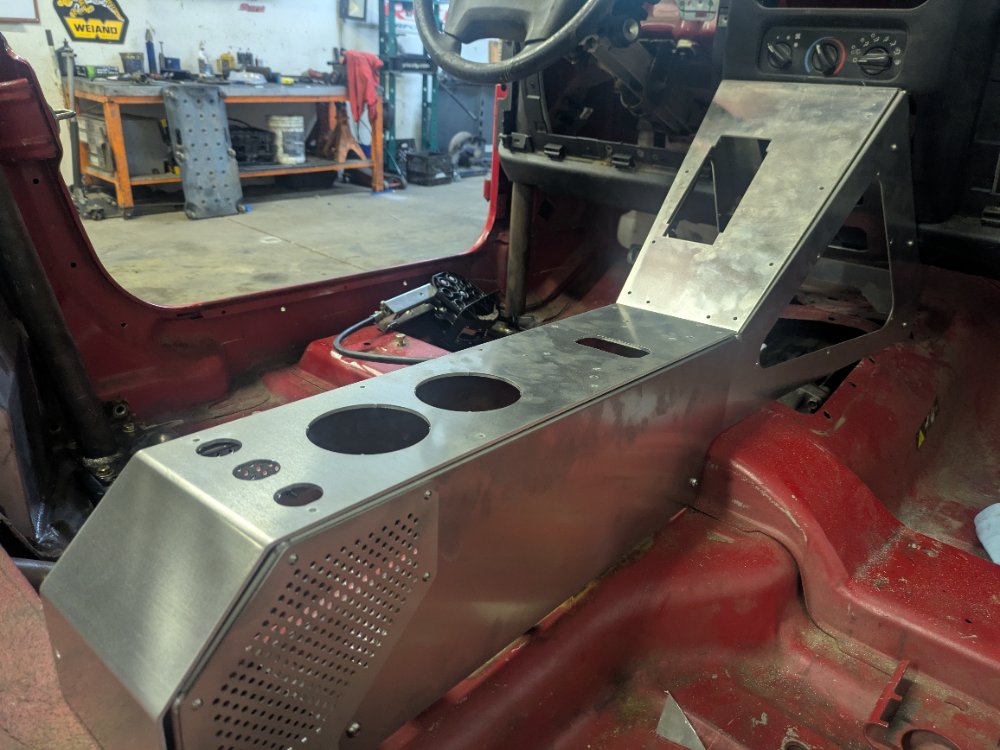

Got the Genright console roughed in pretty much. Had to do some grinding and cutting here and there. But it's essentially all set. Waiting on their aluminum tunnel cover to come in next week and I'll be able to finally get the floor pans done.

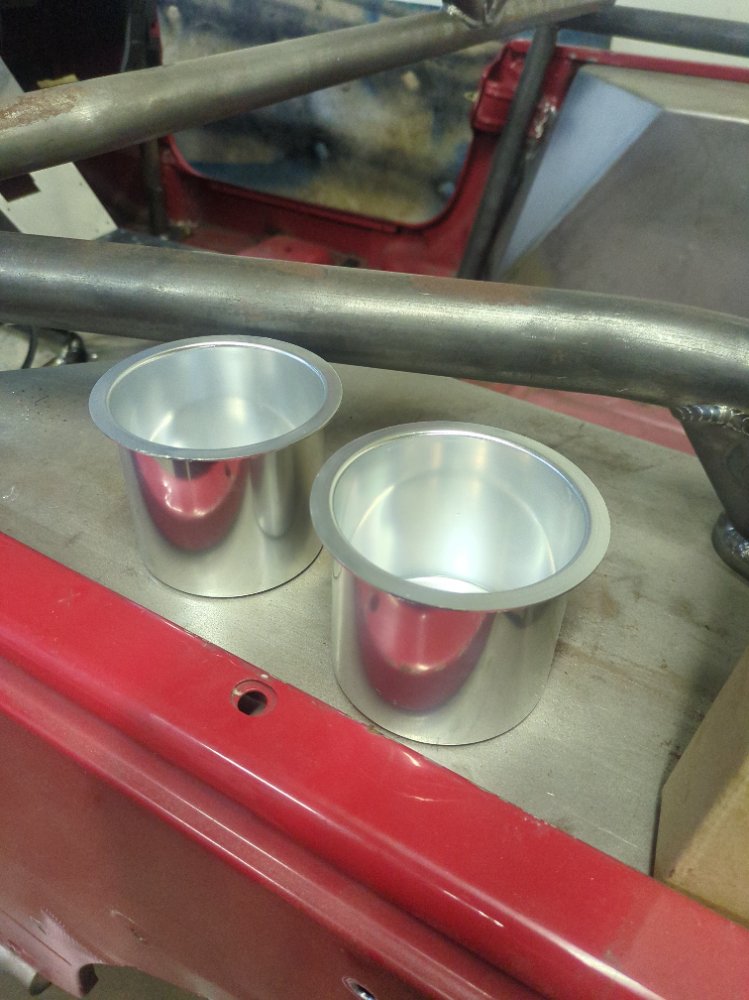

It's got cut outs for the trans shifter, Atlas cable shifters, cup holders and 2 12 volt/USB ports.
