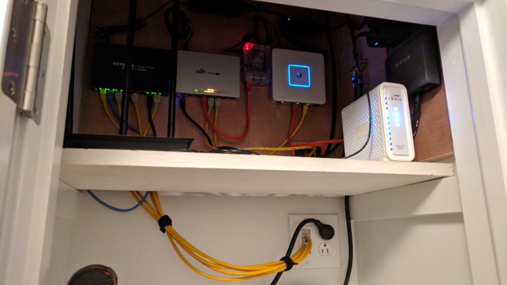

Told ya once before to clean that shit up before posting and bragging.
I couldn't remember if I posted that before or not. But fun fact: it was 104F in that closet, in spite of the louvered door. Last weekend, I cut a 12x4" vent through the wall above the door, and that dropped the temp down to the low-80s.
