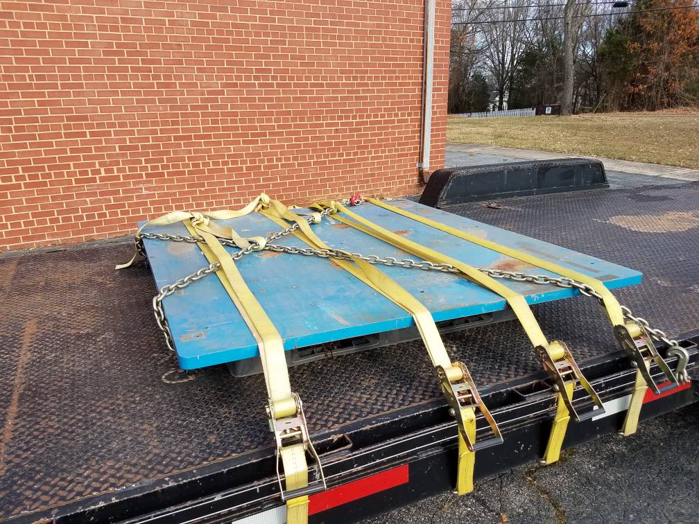

More of a fitup/jig table.
Picked up my new welding table today. Found it on CL. 60x65", 1-1/4 thick, 1400 pounds. Supposed to be blanchard ground both sides. It is flat, flat, flat either way. This was off some machine. Cost me about .15 a pound.
Perfect. We have a couple of almost exactly that at the shop with 5/8-11 on 6" centers. Just floats on a base, when it gets bad flip it over and when it gets real bad put it on the blanchard again.
