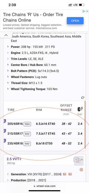

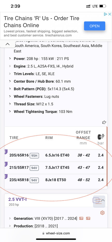

So someone with better google foo than me help. I found a 2019 Camry wheel would this offset be the same as the Sienna?

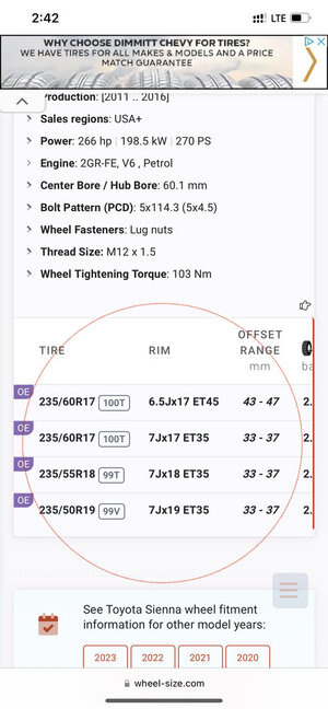

Offsets are different between the Camry and sienna. As a “get home” option, I would think it would be fine.
That being said your sienna has less offset, than the Camry does, by 15mm. (Camry wheel will sit 15mm closer in to the body) So, if you have the room, I think it would work.
First image is for the 2019 Camry, second is the Sienna.

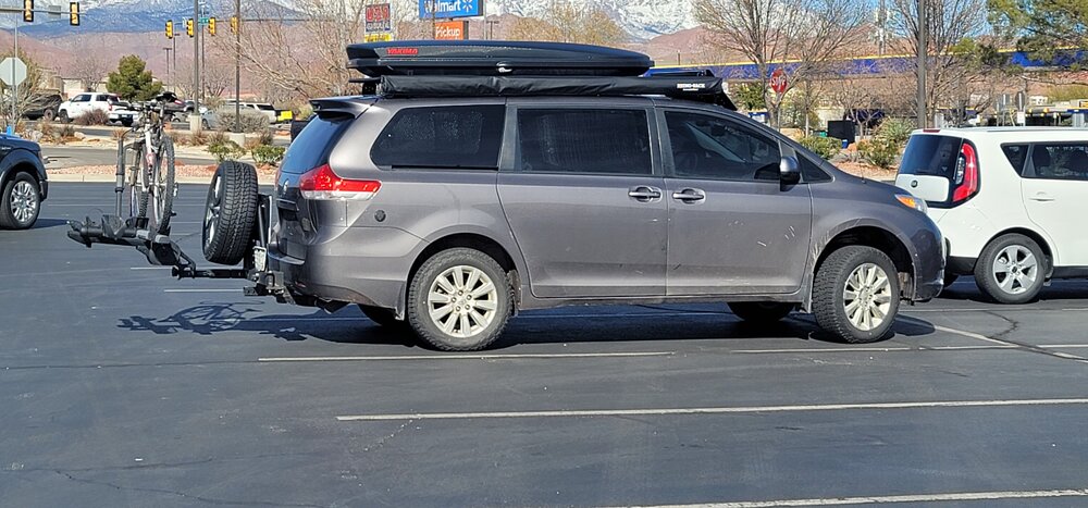

Make a hitch mount for it ;-)
@BigClay
That being said your sienna has less offset, (wheel closer in to the body) than the Camry does, by 15mm So, if you have the room, I think it would work.
Thanks for translating that for me! So the 2019 wheel may work on the rear to get us home. I may go that route

You must pack lighter than my my and kids do for long trips. We end up needing every square inch of space.
Of course our most recent trips were in a Mini, so.... rom for a spare tire is a big wish.

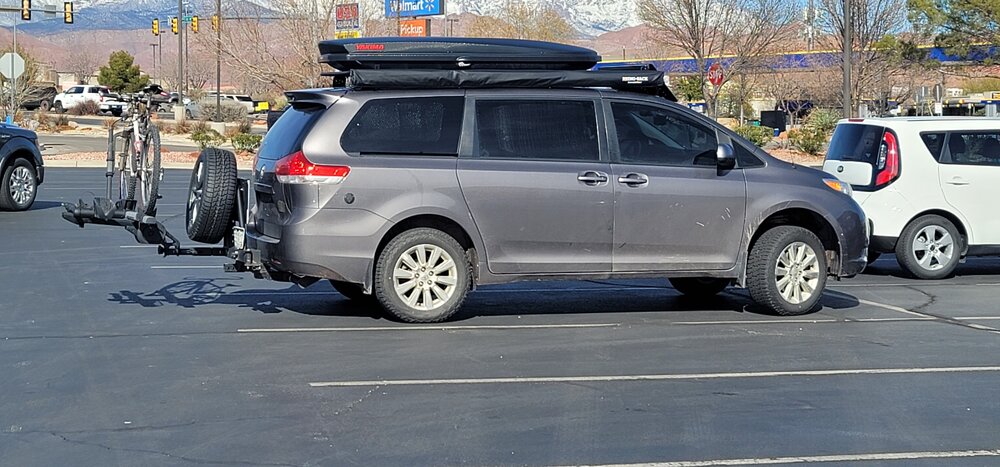

I already have a hitch basket and a roof top carrier bigger than that one :laughing:
So why are you even considering putting that tire in the trunk? It clearly goes on the roof.
