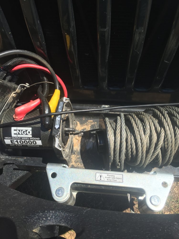

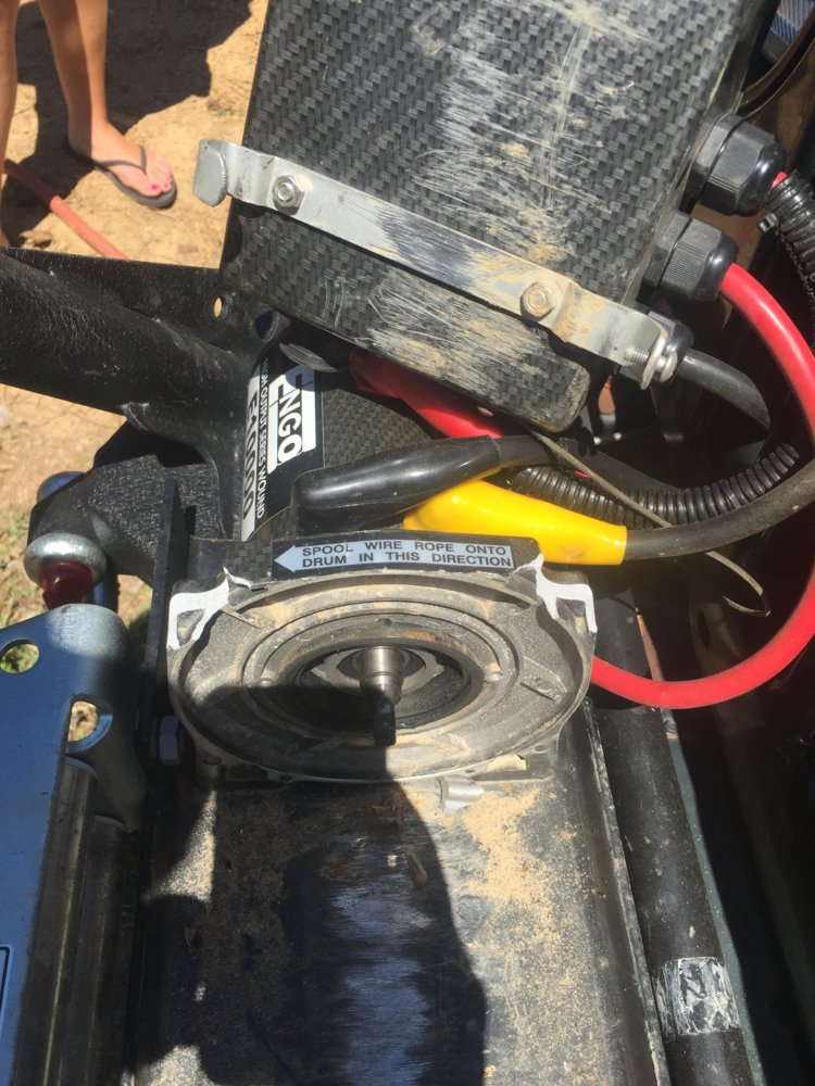

just curious how many of you have had a cable bust or the winch explode. Here's my wich exploded

Was the cable layered okay? Looks like the bottom of your winch plate is pretty rashed from the cable. That bind on the drum could have forced the housing to bust.
The cable was layered ok. It was a few months ago when I pulled a truck out of the mud where it balled up pretty bad. I think I busted a bolt and then the winch housing exploded.

If it balled up enough to take the paint off the bumper, there's nothing to say that it didn't put enough pressure on the spreader bolts to bend them or crack the housing. At that point, its just a matter of time.

The failure I'm seeing is improper use. The cable became bound on the cross supports, which broke them out. After they let go, there was no remaining structure to keep it from grenading.
X2 here....... The cable should have been pulled out fully and rewound. Checking for damage to the cable and drum. I haven't wheeled in a while but after every trip if my winch was used I did this. I'm sure the pot metal housing didn't help either.
The cross supports are still intact it's the housing that gave way and looking at it I believe a bolt broke on the base which made the base of the winch break on the same side and that allowed the winch to twist and break the rest of the housing... I can't imagine spending $1,200 on a good warn winch I think I'll stick with cheap ones and try to be a little safer
