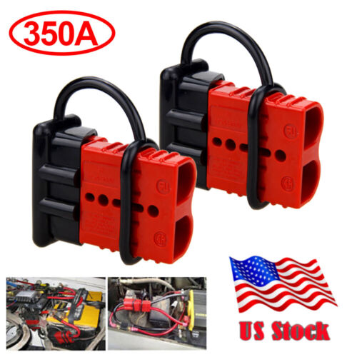

I used one of these off Amazon. Worked great!

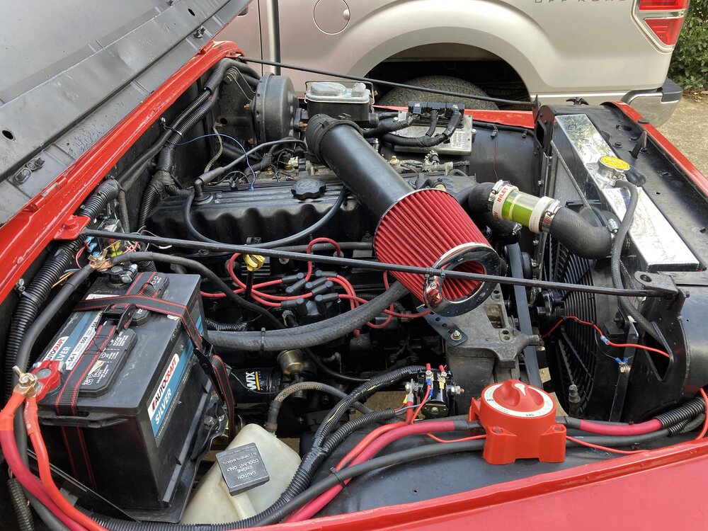

What about a single (simple) "arming" switch vs. disconnect?
Thinking that thru, even disarmed, it could still allow the solenoids to stay latched/locked/welded contacts (that's happened on my homebrew FoMoCo relay setup on the trailer)
You'd be correct.
The other remote option is a constant duty high amp solenoid that could kill power to the winch if youdidn't want a big disconnect somewhere.
i have used the anderson plugs for years on a 12k winch, right beside the winch (easy to reach if needed). even put a plug on one end of my jumper cables so i don't have to open the hood to use them.
