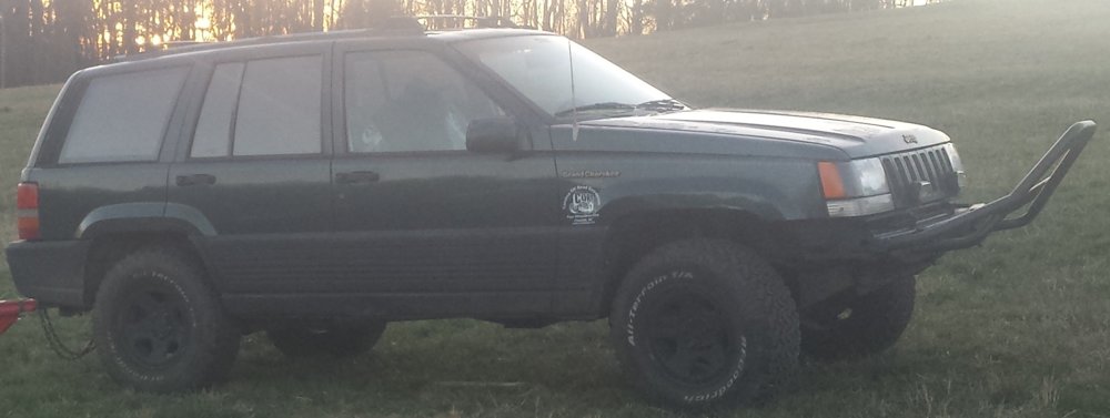

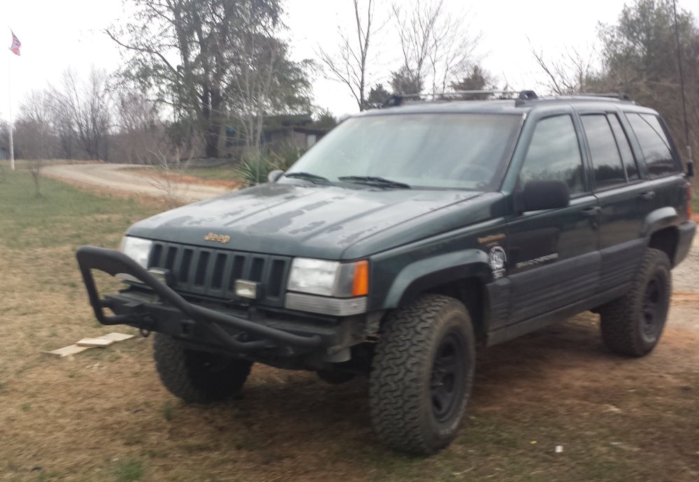

Slowly putting my winch set up together. Ive got the winch and controls. Couple of questions. My front bumper has a hitch reciever and I see some winch mounts that slide into the hitch, are these any good? Otherwise I can just weld/bolt the winch plate to the top of my bumper correct? Also I would like to run a inside control switch and power kill switch. A two way spring loaded switch should work(in, off, out)?
Winch is an old Ramsey 9000 lb, controls are Warn 4 solenoid set up.
Here is the bumper its going on

The answer to all your questions are yes.
Yes receiver, although best for lighter winches and the direct ability to store and use in the rear hitch. Also keep in mind some situations arise that dont allow it to be inserted after the fact. PLAN AHEAD.
Welding to bumper works with proper technique and design. Just like anything else. You'll want some bracing and a good fairlead mount. Incorporating something that does both makes good packaging.
Momentary toggles work great. Just no cheap junk. It doesn't pull the load the winch sees but it does have to handle the circuit to do the job. A continuous load rated fuse or breaker would be highly suggested for an interior mount to protect the circuit.
The first question and the most important one, is one you didn't ask? You may already know or assume but don't skip it. Is this bumper mounted and going to do the job. Plenty of bumpers will do fine for a impact or incidental protection. Few where designed with the intent to be loaded in a pull. Much less pulled in various angles of approach. You need multiple tie ins on different plains to effective mount to that unibody.

Thanks for the response. Good to know that either mount is ok when done properly. If I do an interior switch I'll run a fuse. The bumper is welded to the unibody as well as to plates inside the rail. I assume this should be enough?

If its all tied in properly you should be okay Joel. For your set up, use a receiver mount for now and have the regular remote always available rather than hard wired switches. You'll have to buy the receiver mount, it'll be easier than making it.
