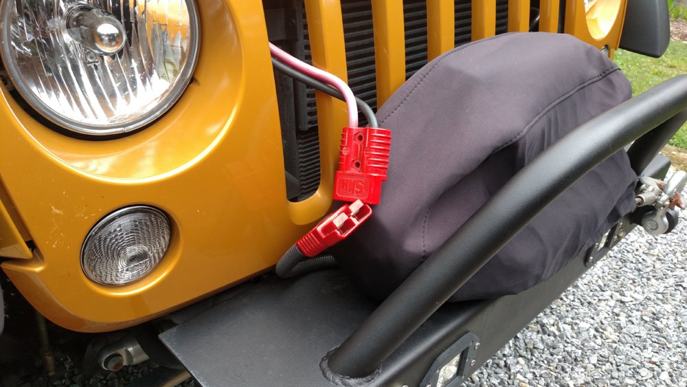

You will not lose any length, probably gain 2 inches. Pic for reference, I keep them tucked in the grill when not needed. They are a great emergency disconnect.

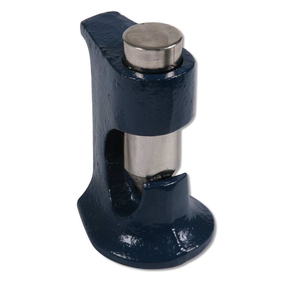

just make damn sure you use a good hammer crimp or hydraulic crimp tool, and heat shrink the lugs after crimping. squeezing with a pair of pliers to crimp lug to cable ain't gonna cut it.
