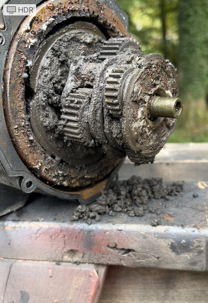

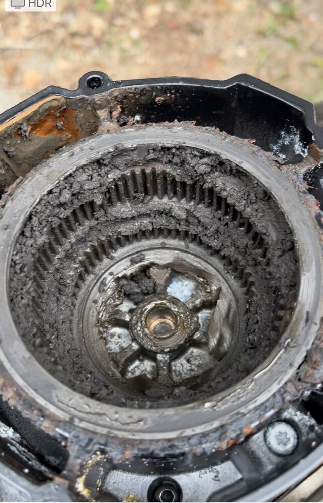

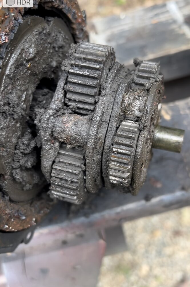

Got this used warn zeon10 and it will not freespool (surprisingly worked well and quiet besides not freespooling). After I get it cleaned out, what grease should I put back and how full should i pack it?
