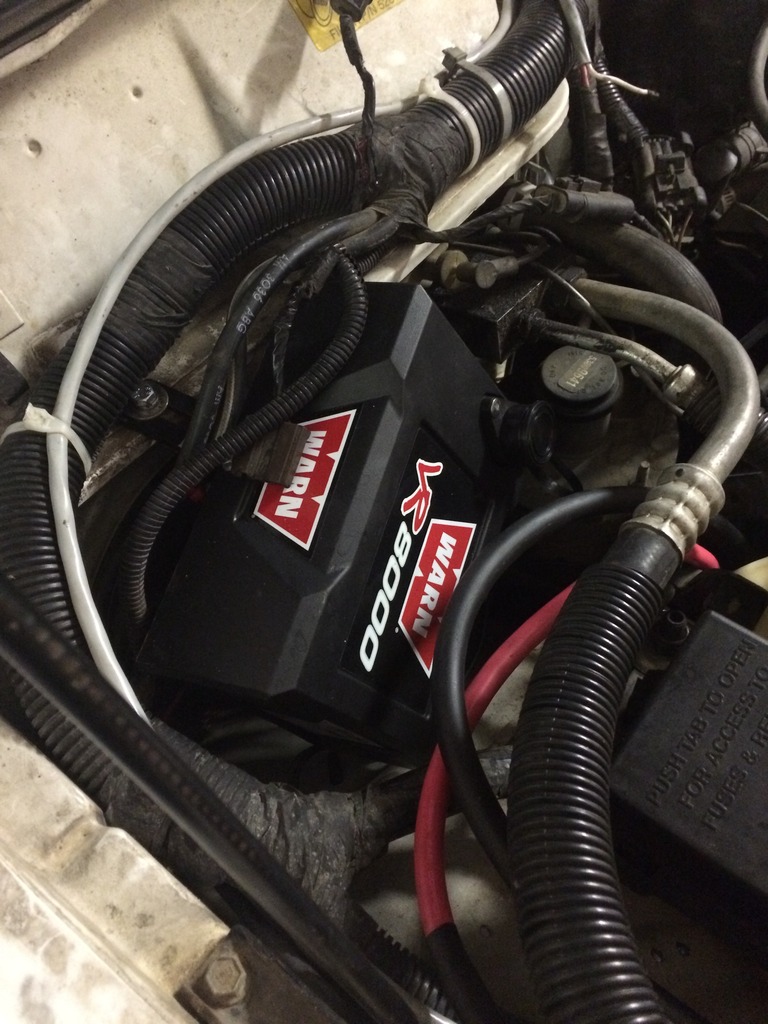

I ditched my window washer bottle under the hood to put my solenoid box there. It'll die from vibrations before weather gets to it.
ai978-photobucket-com_albums_ae262_1tonoffun_jeep_4f561a06_e7dff9651d631188dfa2cc38248262d7948-jpg.223390
