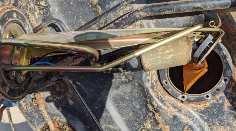

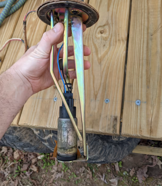

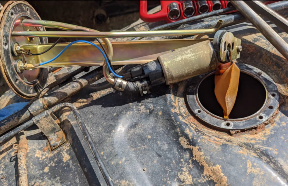

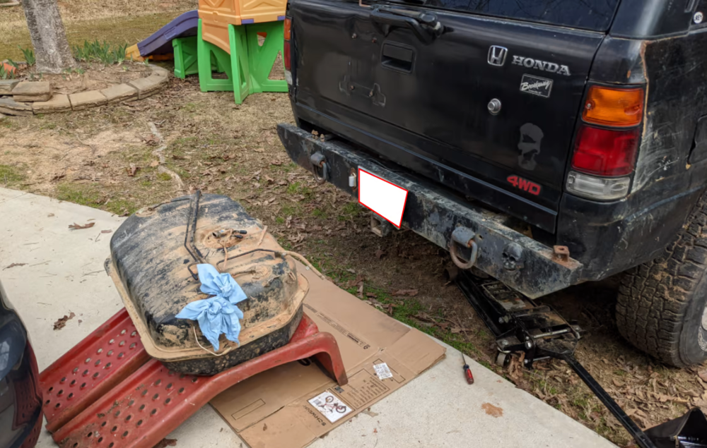

Post Windrock trip I had some damage I had to repair. The fuel tank was used by a massive rock to lift the entire truck off the ground and I had not put the skid back on yet. luckily the fuel pump/pickup was there to hold the load and not COMPLETELY taco the tank. About 3 hours of hammering to get the sump in the tank back down to the correct location and some pickup bracket/piping reshaping she is back to order. Next for the tank will be lifting it a bit and figuring out how to get the skid back on. The motor mounts went, so the entire driveline shifted back and caused the shifter boot assembly to pull from the body in the front. Sure was a noisy trip home with this GIANT hole. I've also got some new body damage, but it is difficult to see it since it goes down the entire side of the truck and just emphasizes the structure in the doors; Somewhat like a wet t-shirt contest.
