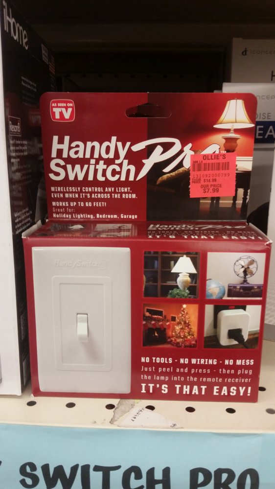

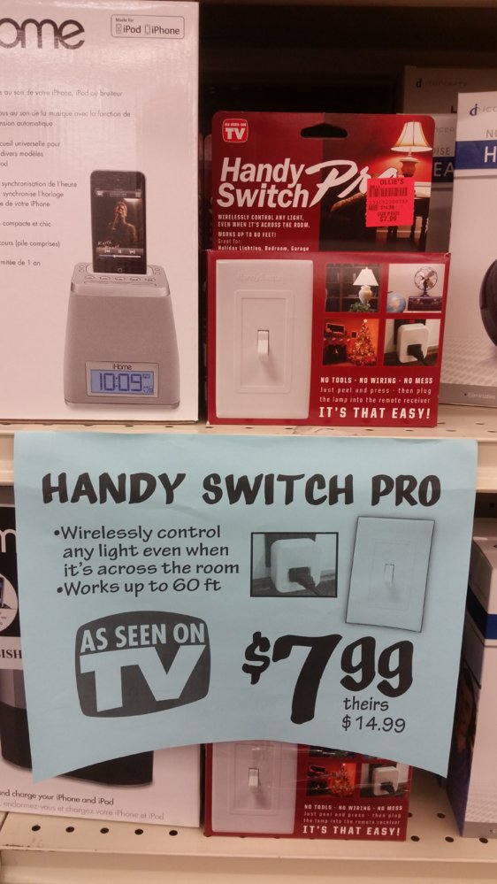

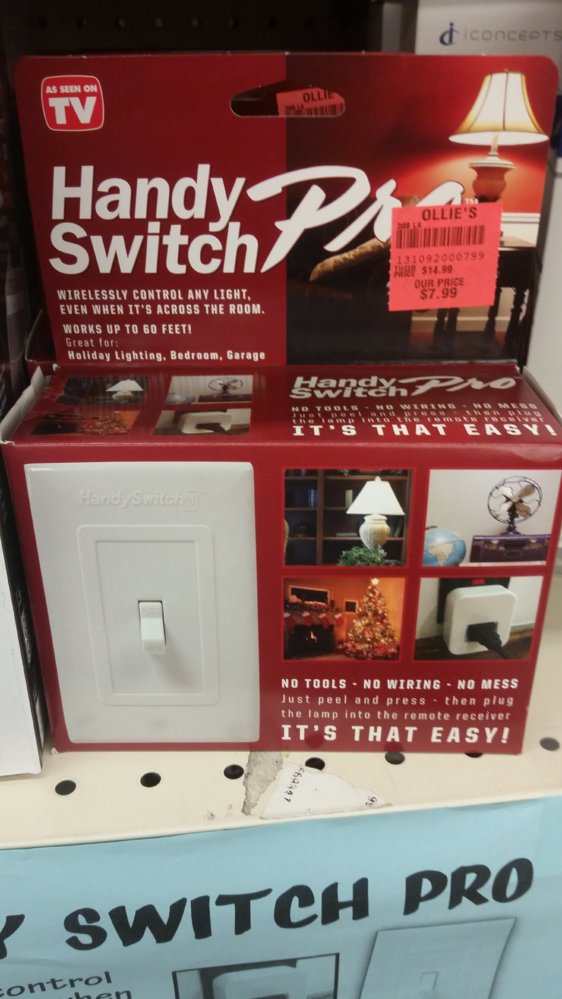

Will this work? 7.99 at ollies. As seen on tv
No - that controls a plug you have on the wall.
But - definitely good to know. Thats pretty cheap. We have an Ollies here nearby, curious if they have them too.
